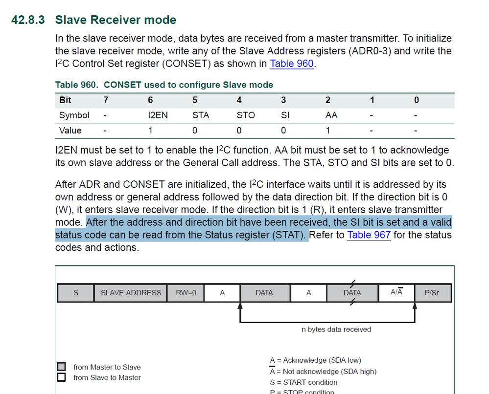

I am using LPC1830 slave i2c, there is an issue.
For slave i2c, it use interrupt to receive data. I check the i2c waveform, the LPC1830 HW is correct, all bytes from master are received because each byte have ACK from LPC1830.
But in SW, the interrupt only happen when all transaction is complete, it means the interrupt will only 1 times no matter how many bytes send.
The correct behavior should be each byte will trigger an interrupt and the i2c slave RX buffer receive these bytes.
I don't know why only all transaction is complete, and it will trigger one interrupt.
(I had evaluate the same source code on LPC1857, it's work. But for LPC1830, it's fail)
Please give me some comment.

kerryzhou
Hi Ken Su,
     The SI is the I2C interrupt Flag, this bit is set when the I2C state changes.
   So, you can check your I2C state, whether the state is changed?

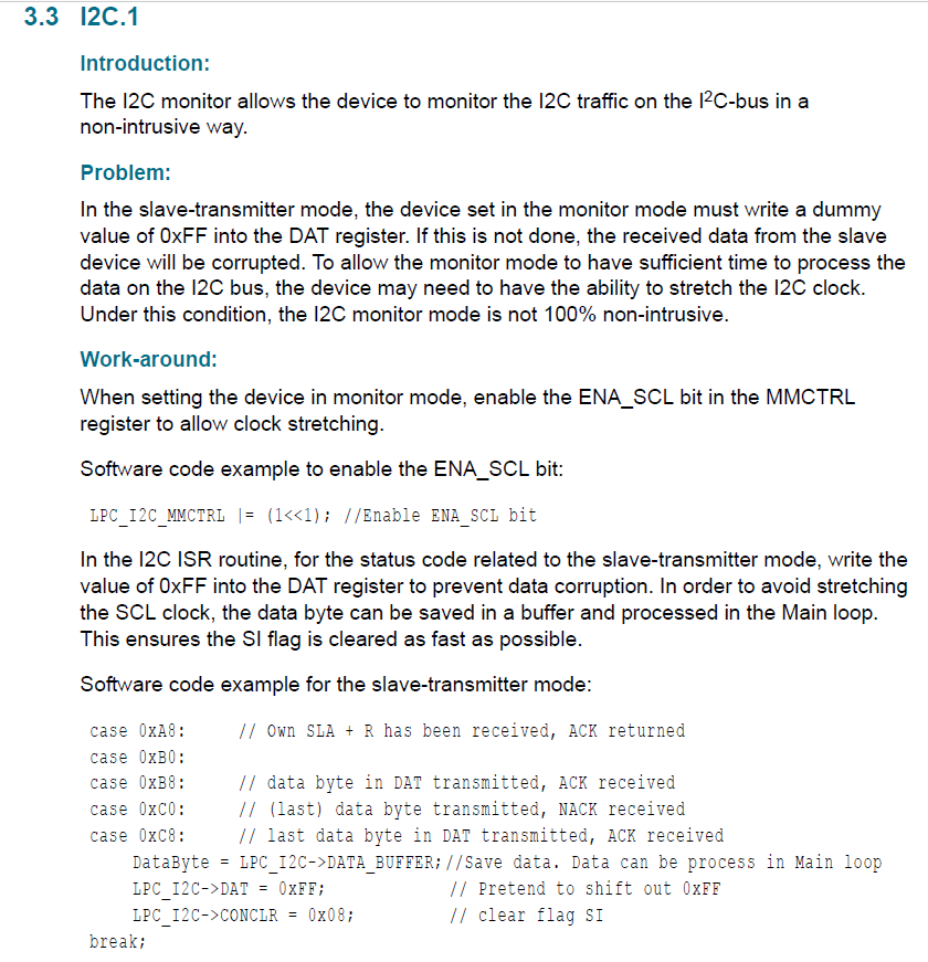

Besides, I find in the errata, there has some descriptions about the I2C, you can do the work-around about it.
Wish it helps you!
If you still have question about it, please let me know!
Kerry
