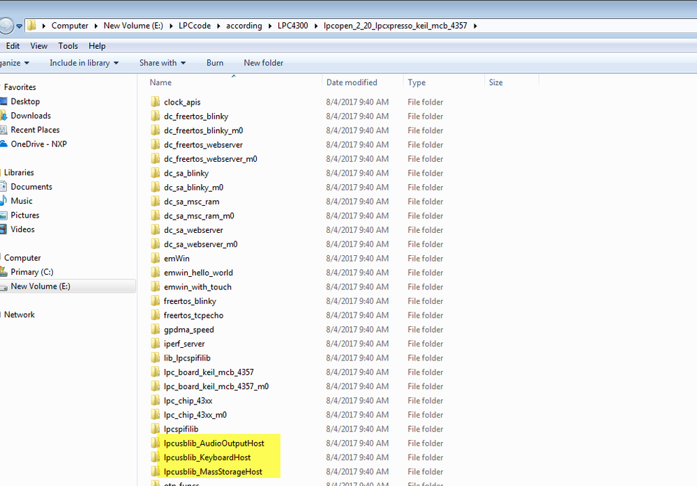

I’m developing USB host function for LPC4337 (Evaluation board OM13070).
But I cannot find out sample codes nor documents to help to make USB host function.
I download “lpcopen_3_01_lpcxpresso_nxp_lpcxpresso_4337”.  There are many USB device sample code in it, but no sample about USB host.
I read USB ROM stack 1.0 document, but all API seems to be for developing USB device.
I’d really appreciate if somebody help me.

Hello Yasushi Aoyama,
    I find in the old lpcopen for MCBLPC4357, there has some USB host code, so you can refer to that code.
   It seems you are using LPCXpresso IDE, then I attach the sample code for your reference.
Wish it helps you!

Thank you very much, Kerry,
 I also found "lpcopen_2_20_lpcxpresso_nxp_lpcxpresso_4337" still has similar USB host code.  These code seems to be removed from ver 3_xx.  I checked release note of lpcopen_3_xx, but there is no description about removing USB host
 code.

Hello Yasushi,
   Yes, I also find the 3.xx removed the host code, that's why I give you 2.20 code.
   You can refer to the 2.20 code directly.
