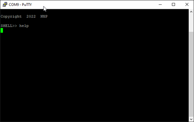

I am using an LPC55S06-EVK board to do some initial evaluations of the microcontroller, and seem to have an issue communicating using a Serial USB Connection through Link-2.  I followed the quick-start guide, including updating using LPCScrypt to 2.1.2, and I am using the IAR IDE SDK.  I am able to receive the traffic from the MCU -> PC through USB just fine, but any data transmitted from PC -> MCU don't work. This happens on both the Shell and Power Evaluation examples included in the SDK.

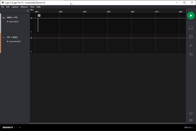

Investigating the Jumpers, I believe everything is correct.  JP12 is open, allowing J3 to be used for monitoring the UART traffic to the MCU.  I can see and verify the data being sent from the MCU to PC using a Logic Analyzer, but can't get data from the PC to MCU to show up.
I have tried a different cable, which didn't change the behavior.  This has lead me to believe the LPC4322JET100 that is being utilized as a passthrough from USB to UART is not transferring the data correctly.  Have others had this problem, is this an isolated issue, or something else?

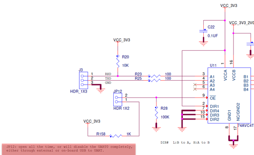

First is the schematic for the board, it mentions "JP12 is open all the time, or it will disable the UART0 completely, either through external or on-board USB to UART" (pg 4).  This, to me, meant JP12 needed to be open or UART0 wouldn't work using any of the options.  This didn't specifically mention J3 wouldn't work, so my assumption was all UART0 lines wouldn't work.  The problem is without connections to J3, it will hold the RX line high, and the level shifter just puts out a high signal, drowning out the signal from the USB.
Also in the schematic, JP12 is listed as OPEN by default, which is what I was using for my information mostly.  This should be CLOSED ("1-2") to allow USB UART to work on start. The boards were shipped with JP12 Open, but doesn't match the LPC55S06-EVK User Manual defaults (get to that in a minute).

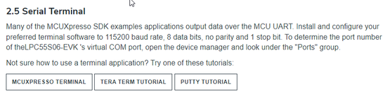

When going through the steps, 2.5 doesn't mention anything about making sure a jumper for JP12 is closed to make this work.  It also is referencing Serial over USB, so if it isn't referenced here I would expect to be able to just plug and play with Serial over USB straight out of the box.

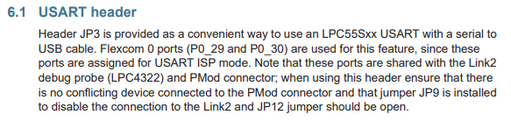

Lastly, is the LPCXpresso55S06 Development Boards User Manual.  This is the one document I think was the most "correct", as the definition for JP12 actually mentions it needs to be installed to use USB to UART0, and JP9 needs to be open (default and correct). However, it notes JP12 is "Installed" by default, which the boards are not shipped that way (which I think is the fundamental issue with the EVK boards).
Section 6.1 also correctly goes into the details of how to jumper the board for JP12, JP9, and use J3.
For a fix to this issue, I think JP12 needs to be switched to ("1-2") on the schematic, the JP12 note I mentioned in the schematic be updated with better wording, and the boards be shipped with JP12 shorted.  If these would have been different, things would have been better!

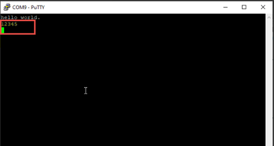

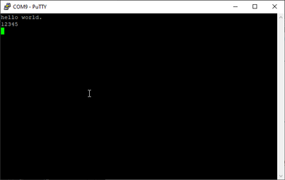

If use J3, the same issue on my side. How about use the USB port J1, and short J12, I test it on my side, it can works well, below is run hello_world demo on my side, send same data 123456 from PC to MCU, MCU can received them and send them:
Alice
10,069 Views

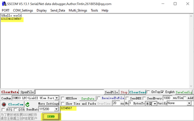

From your screenshot, it seems UART send/receive all work well. Do you used J3?

I did not get a response back per hello_world demo.  It should echo everything passed in, which it did not.  I would expect something like your screenshot, where there is an extra 12345 in the image.  Or like for the shell demo, I should get details by typing in "help". This is using J1 for USB Serial, J3 is only being used for the Protocol Analyzer to observe the traffic data.  The data from the PC to MCU is just never reaching the microcontroller

Just confuse,  from your screenshot, there is echo "12345".

I thought I had mentioned it  in my first response before but I must have deleted it.  I have local echo on to verify what I was seeing.  That would explain why it looked like it was on for you, but meant it was off for me.  Sorry about that, that was my fault.
