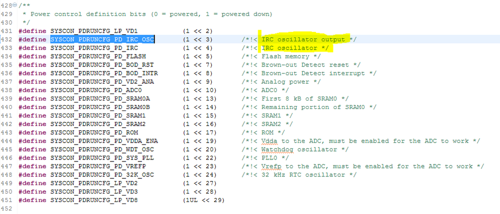

What is the difference between these two Power Switches?
LPCopen file: syscon_5410x.h
SYSCON_PDRUNCFG_PD_IRC_OSC

Keep mind: To enable the IRC oscillator, these two bits should work together, they're inseparable.
