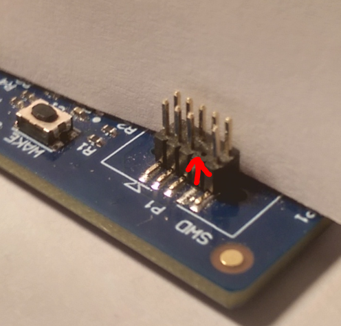

On the OM13077 Development kit, the ISP Pin on the SWD Debug Port is missing. The SWD Header has no pin on position 7!!!
Found this issue while trying to debug / flash a LPC54120 which wasn't responding.
I tried the solutions from the FAQ but no one was working. Then I checked the ISP connection to my board and noticed, that the ISP pin was never pulled low.
I had to connect the ISP (pin 7) manually to my target board.
Thank you NXP, I had some fun debugging, why my target doesn't want to respond. (There was no single note for this issue)

Hi Simon Wyss,
for the opportunity to serve you.
Getting Jumper JP1 opened, then try again.
