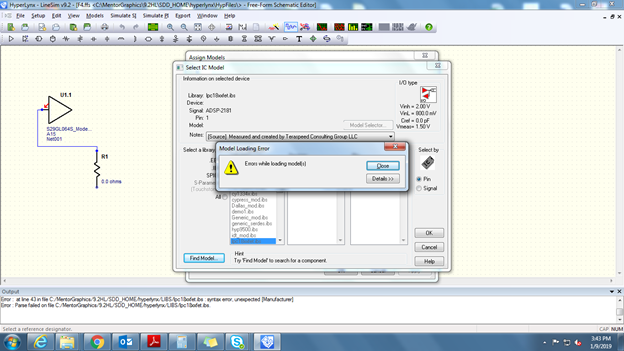

bernhardfink
The file passes at least the standard syntax checks for an IBIS file v4.2.
Do you have any error message from the tool which could help to analyze what#s wrong with it?
Bernhard.

manish_sharma2
Screenshot of the error while importing the IBIS file.
Tool using is: hyperlynx V9.2
4,058 Views

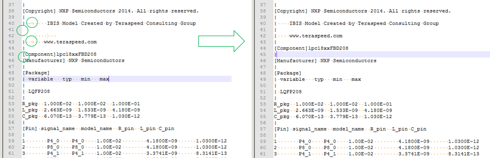

bernhardfink
Can you please give it a try after applying changes in the IBIS file.
- remove the 2 tabs
- replace empty line by a line starting with a  |
- insert a line starting with a  | between [Component] and [Manuafcturer]
Bernhard.

manish_sharma2
HI Bernhard,
modified the file as suggested.
still the problem persist.
Moreover, I am able to import the file in hyperlyx version 8. But there the part is showing only INPUT. So i am not able to drive my signal.

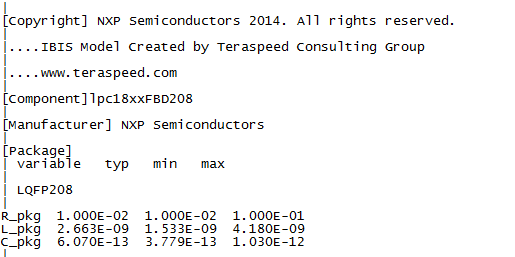

bernhardfink
Hi Manish,
try it with another modification:  add a space between [Command] and lpc18xxFBD208
The data for the Hitex Rev A4 board is attached.
Bernhard.
