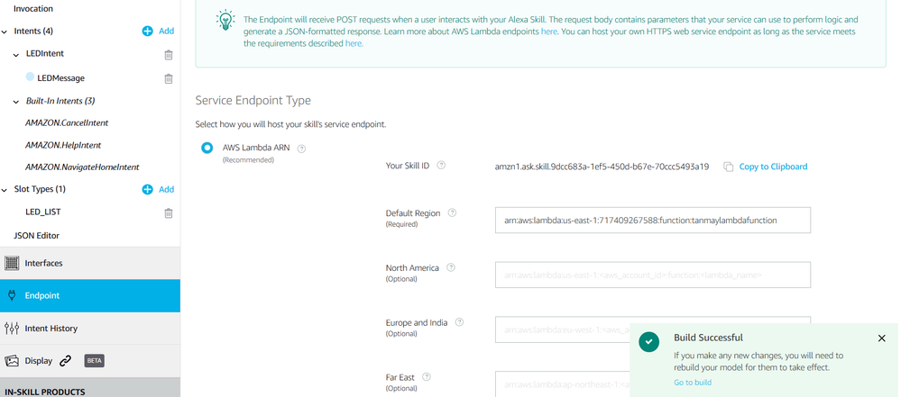

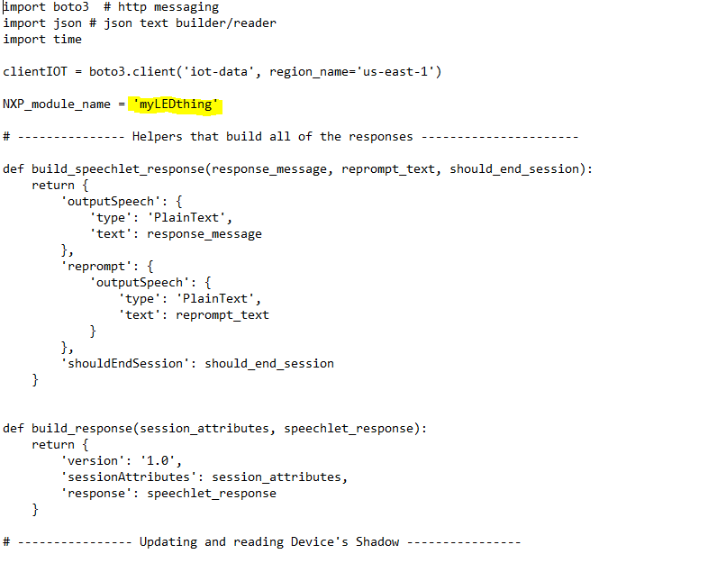

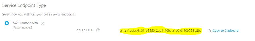

Sabina_Bruce
Hi Tanmay,
Firstly, based on our companies policies I cannot take your log in credentials.
I have now successfully replicated the project from my side and am able to turn on and off the led using Alexa. However checking all your information with detail, I noticed that the name of your Thing in MCUXpresso is 'myHomething' and in your lambda function that you provided in this thread you are saying 'myLEDthing', so that is an important difference.
With that being said your certificates will also not match what it should be.
So now here are a couple things you need to verify and provide screenshots:
1. Make sure the name of your thing is the same in your MCUXpresso application and in your lambda function.
2. Also verify that in the aws_clientcredentials.h, the clientcredentialMQTT_BROKER_ENDPOINT has the correct url. This is located in your Thing -> Interact

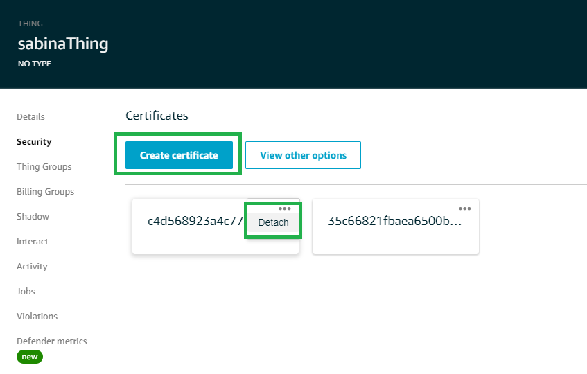

2. Now download the thing's credentials keys again, so you can regenerate the aws_clientcredentials_keys.h. From your thing click on the security tab and detach both existing credentials. Then click create certificate again, so you can download the private key and the certificate for your thing and click activate.
Here you can follow the directions from your lab so you can regenerate the aws_clientcredentials_keys.h file and copy it to your project, save and build.
3. Next Verify that in the Alexa Skill Kit on your lambda your skill ID is enabled and matches your skill's endpoint.pastedImage_15.pngpastedImage_16.png
4. Lastly make sure your skill has the correct Lambda URL.
Once you have verified all these key sections build and run your program again. Please check to make sure your serial window looks similar to mine, of course specific details should match your own.

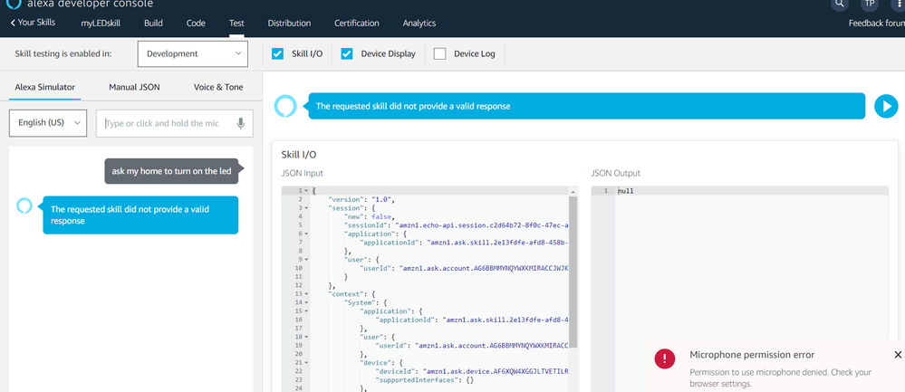

tanmayparashar9
Thank you for your response.
I am still getting a response as LED is OFF
I followed everything as above and here are the screenshots
I was testing it using alexa simulator and this is what i got:
How do I fix this?

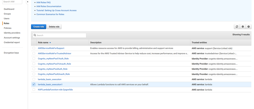

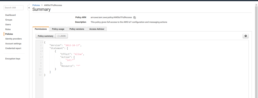

Sabina_Bruce

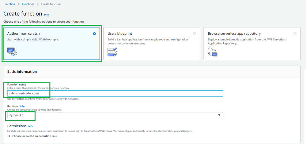

Hi Tanmay,
   Thank you for the information this helps me alot. At the moment I'm recreating exactly what you have done following the lab you shared with me. One thing that popped out at me is the main screenshot of your lambda. Yours is different from the one I created. On yours you have the Amazon FreeRtos (which does not contain the correct permissions you need), it should be the Amazon CloudWatch Logs.

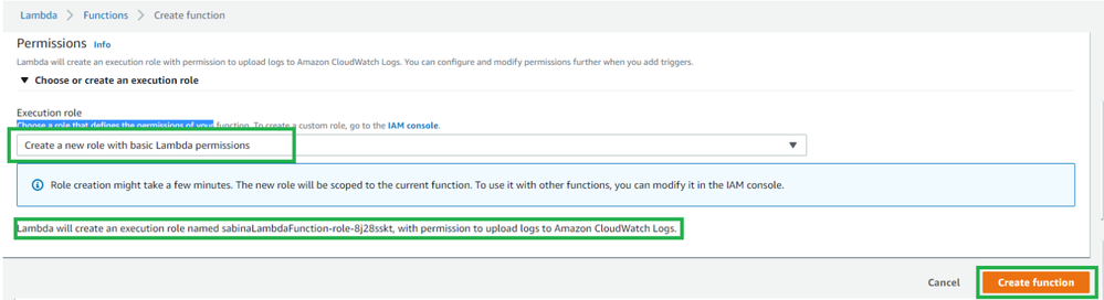

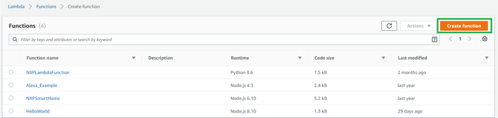

So I recommend creating the lambda function again following these instructions and the screenshots I have provided:
From Services > Compute > Lambda:
1. Create a new function:
2. Click Author from scratch, type in the name of your lambda function and choose python 3.6
3. Open the choose or create an execution role and make sure the execution role is the one shown below and at the bottom of the screen it shows that your lambda function with permissions to upload logs to Amazon Cloud watch Logs.

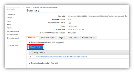

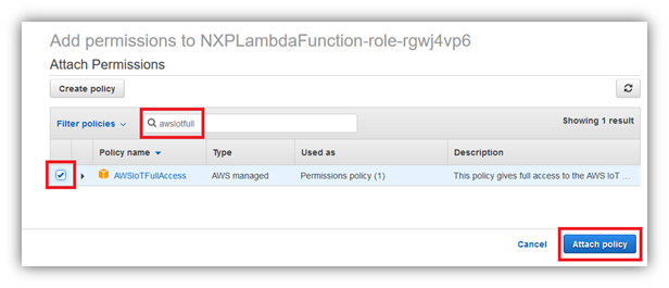

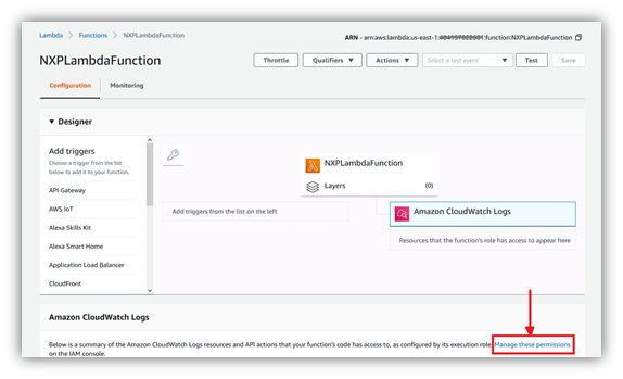

Once you have created your lambda. Click on the “Amazon CloudWatch Logs” icon and scroll down to the “Amazon CloudWatch Logs” section. Click on the “Manage these permissions” link. This will take us to the IAM console, where we can assign the permissions to our NXPLambdaFunction role.pastedImage_7.png

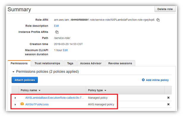

 Click on “Attach policies” button.
Type “awsiotfull” in the filter.
Select the “AWSIoTFullAccess” policy.
Click on the “Attach policy” button.

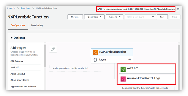

Verify that your role has now two policies: the AWSLambdaBasicExecutionRole and the AWSIoTFullAccess policies.

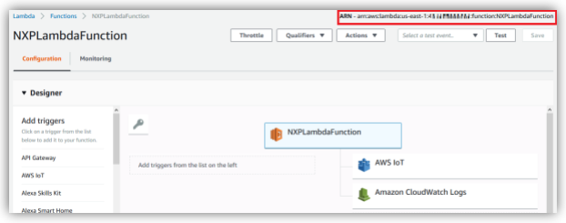

Go back to your NXPLambdaFunction and verify that you now has “AWS IoT” resource available for your Lambda function.
Scroll down and locate the editable function code window and erase the preconfigured code.
Copy-paste the content of lambda script code into code window.
Lastly configure the timeout to be 10 sec
Make sure you copy correctly the new ARN of your Lambda Function to your skill.
Let me know the results of these changes,
Sabina

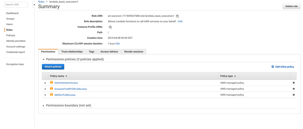

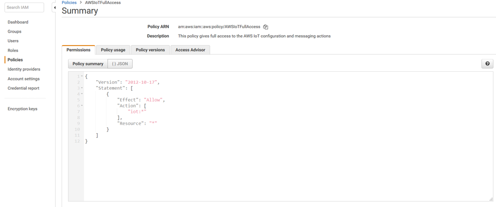

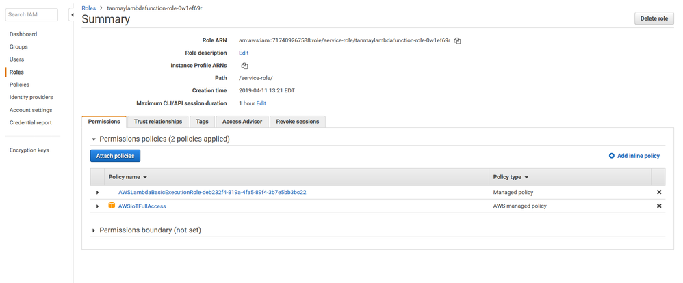

tanmayparashar9
Thank you for your reply.
1) Now I am using SDK 2.5.0
2) Here are the following screenshots:
Path-
IAM- roles ( lambda_basic_execution1)- policies- AWSIOTFullAccess
Does this help?
Tanmay

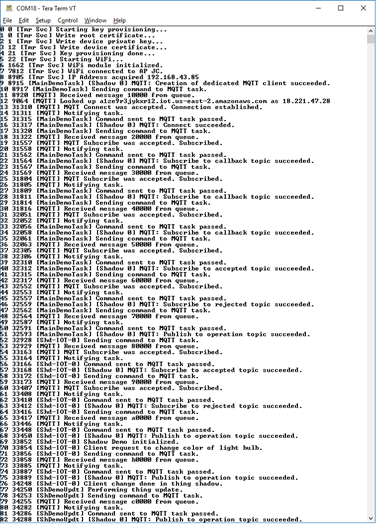

tanmayparashar9
Thank You for the information.
To answer each of your questions,
1)Can you confirm the SDK version you are using?
 SDK version 2.3.1

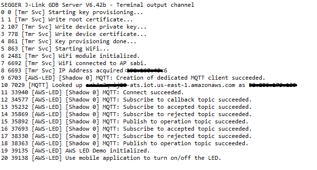

2) Can you share the output in your serial terminal when you run the program? Here is an example.
I have attached a word document here which has the screenshots of the outputs on my serial terminal.

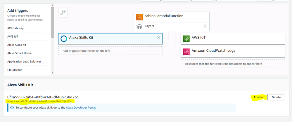

Sabina_Bruce
Hello Tanmay,
First I would highly recommend downloading the latest SDK as there are some known bugs with that version. However because you are able to control the LED directly with the shadow, I would like to check your policy first.
Can you please share some screenshots of your Lambda's Function main screen right before you can edit the content. Like this imagepastedImage_1.png
Next click on AWS IoT then Manage Permissions then Roles and select the created role, for example lambda_basic_execution.
Can you show me a screenshot of the page when you get here. You should see AWSIoTFullAcess policy. If so can you click on the policy so we can see the content.

tanmayparashar9
Hello
I have attached a word document here. This has screenshots of the AWS lambda and Alexa Skills page. It also has the Lambda and JSON script that I have used.

Sabina_Bruce
Hi Tanmay,
Thank you for the information. To answer the last question, the credentials are different in Alexa skills and AWS-Lambda/IOT, as they are different platforms, so it is not an issue.
I have some new questions:
3) Are you able to control the LED using the android application?
4) Are you hable to control the LED writing directly in the shadow? An example is shown below:
Let me know the results.
Thank you,
Sabina
