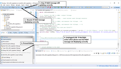

So following on from This post I selected Quickstart --> set library/header --> redlibnohost. I then debugged and ran the code.
At this point when i bring the phone near the tag, The LED goes red and the message  " adc_1: 0....." is displayed.
I then stopped debug and the message still updates normally every time i bring the tag in contact.
I disconnected the USB from the PC, now the tag RED LED lights up, but as previously NO message "Tag is empty or not alligned"
Below is extra information incase the issue isn't a simple fix:
Here I am assuming that the steps "Debug-->Resume-->stop Debug--> disconnect USB" Should allow the chip to have the program onboard, since it works with the blinky example ?

After debug-resume --> message is updating correctly
Stop --> message still updating correclty
Remove USB --> tag is empty or not alligned

leo94
Do you have precise instructions to set semihosting to NONE?
I might be giving infomation that isn't relevant here, but a difference i see between my project and one like Blinky are:
Image 1: The DAC_ADC_toghether folder view : It doens't create a Release.launch (like blinky does)
2. I have checked in properties, but i cannot see other options:
3. For Blinky (that works also whilst disconnected from PC and only in NFC presence) i have a release available:
Please let me know the steps to remove semihosting.
