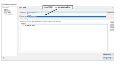

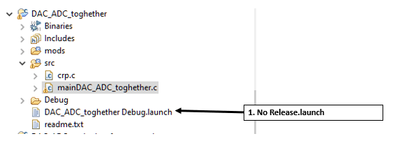

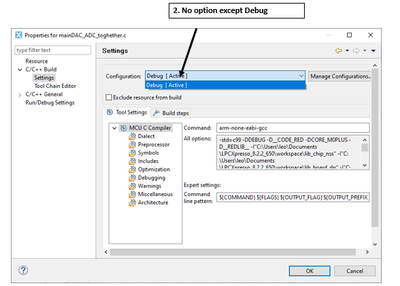

The code is working, however i cannot remove semihosting becuase i am using a sprintf (Link to question with dries comment )
I have the following questions:
1. Can you confirm that i cannot flash to NHS3152 due to sprintf ?
2. How do i commit a message that contains the values of the variables V1, V2, I, RES ?
I basically need to be able to disconnect the NHS3152 from hte LPCLINK, and still see my code running, but its been quite frustrating and everything i've tried hasn't worked, obviously i am not able to understand what the issue is.

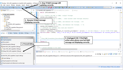

So following on from This post I selected Quickstart --> set library/header --> redlibnohost. I then debugged and ran the code.
At this point when i bring the phone near the tag, The LED goes red and the message  " adc_1: 0....." is displayed.
I then stopped debug and the message still updates normally every time i bring the tag in contact.
I disconnected the USB from the PC, now the tag RED LED lights up, but as previously NO message "Tag is empty or not alligned"
Below is extra information incase the issue isn't a simple fix:
Here I am assuming that the steps "Debug-->Resume-->stop Debug--> disconnect USB" Should allow the chip to have the program onboard, since it works with the blinky example ?

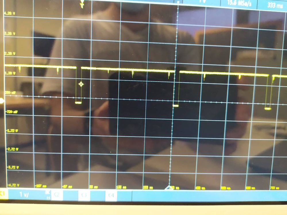

I have setup the code with Chip_GPIO_SetPinOutHigh instead of toggle since it was clearer in the oscilloscope. I place a HIGHbefore the For loop, then LOW after Store values and HIGH after generate ndef; as shown below:
Chip_IOCON_SetPinConfig(NSS_IOCON, 7, IOCON_FUNC_0 | IOCON_RMODE_INACT | IOCON_LPF_DISABLE);
Chip_GPIO_SetPinOutHigh(NSS_GPIO, 0, 7);
for (;;) {
Chip_stores_values_in_fixed_memory_location_in_EEPROM();
Chip_GPIO_SetPinOutLow(NSS_GPIO, 0, 7);
GenerateNdef_TextMime();
After debug-run while still connected, I have:
  • The signal goes LOW at 333ms after : Chip_stores_values_in_fixed_memory_location_in_EEPROM
  • Then goes HIGH at 350ms (17ms after) after: GenerateNdef_TextMime();
With HIGH =3.3V
I then disconnected the USB cable and powered by NFC (phone):
I get the same results except High is 1.9V instead of 3.3V
What do you think the problem is? Perhaps the message isn't being retrieved from EEPROM ?
Thanks for your help,
Leo

Can you measure the time it takes from the moment main gets control and the call to GenerateNdef_TextMime finishes? And then to when Chip_stores_values_in_fixed_memory_location_in_EEPROM finishes? You can toggle a pin at different locations and detect the flank changes with a scope to measure this accurately.
To toggle pins i have parts of the code from Example 1 - Configuring individual pins. I have toggled pin 7 with "Chip_GPIO_SetPinToggle(NSS_GPIO, 0, 7);"  4 times, next line after
  1.  Chip_reads_a_fixed_memory_location_in_EEPROM();
  2. GenerateNdef_TextMime();
  3. sprintf((char *)sText...
  4. Chip_stores_values_in_fixed_memory_location_in_EEPROM
Below is the main part of the code that i intend to run tomorrow. And i Will let you know the results.

Image 1: The DAC_ADC_toghether folder view : It doens't create a Release.launch (like blinky does)
2. I have checked in properties, but i cannot see other options:
3. For Blinky (that works also whilst disconnected from PC and only in NFC presence) i have a release available:
Please let me know the steps to remove semihosting.

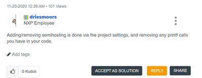

converse
Senior Contributor V
Set semihosting to NONE. sprintf is not semihosting, but printf is (semihosting means that any i/o operations are carried out on the host - such as file read and write). sprintf does not use i/o.
