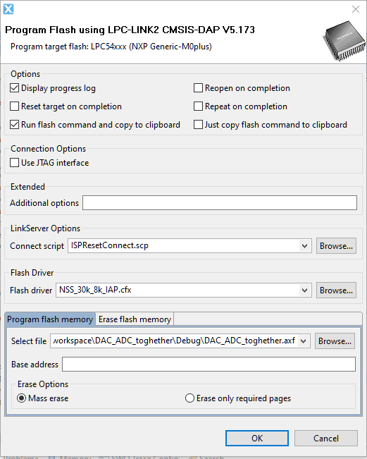

I am trying to use NHS3152 DEMO BOARD to read a resistance.
The program works fine except an issue with the scale.
I am now want to flash the program onto the NHS3152 DEMO board's chip, so that it can run without being connected to the PC and LPC-LINK2.
I am doing the following:
1. Press flash icon and connect to emulator --> press OK
It opens Program Flash using LPC-LINK2 CMSIS-DAP V5.173
I chose:
Options:
  • Display progress log
  • Run flash command and copy to clipboard
Connect sctrip: ISPRestetConnect.scp
Flash driver: NSS_20k_8k_IAP.cfx
program flash memory
select file: ...\DAC_ADC_toghether.axf (see code at end of Quesiton)
Erase Option: Mass erase
And pressed OK.
I get the following message out:
Nc:verify offset 0x2400/0x45B0[0x400/0x400]
Ps: ( 57) at 00002400: 1024 bytes - 10240/17840
Nc:verify offset 0x2800/0x45B0[0x400/0x400]
Ps: ( 63) at 00002800: 1024 bytes - 11264/17840
Nc:verify offset 0x2C00/0x45B0[0x400/0x400]
Ps: ( 68) at 00002C00: 1024 bytes - 12288/17840
Nc:verify offset 0x3000/0x45B0[0x400/0x400]
Ps: ( 74) at 00003000: 1024 bytes - 13312/17840
Nc:verify offset 0x3400/0x45B0[0x400/0x400]
Ps: ( 80) at 00003400: 1024 bytes - 14336/17840
Nc:verify offset 0x3800/0x45B0[0x400/0x400]
Ps: ( 86) at 00003800: 1024 bytes - 15360/17840
Nc:verify offset 0x3C00/0x45B0[0x400/0x400]
Ps: ( 91) at 00003C00: 1024 bytes - 16384/17840
Nc:verify offset 0x4000/0x45B0[0x400/0x400]
Ps: ( 97) at 00004000: 1024 bytes - 17408/17840
Nc:verify offset 0x4400/0x45B0[0x1B0/0x400]
Ps: (100) at 00004400: 1024 bytes - 18432/17840
Nt: Erased/Wrote page  0-17 with 17840 bytes in 6667msec
Pb: (100) Finished writing Flash successfully.
Nt: Flash Write Done
Nt: Loaded 0x45B0 bytes in 7358ms (about 2kB/s)
At this point however if i bring the phone into the NFC range it reads:
"Tag is empty or phone is not aligned" instead of the expected "res value is.. "
The program works since if I run it via Debug session it runs. but even here if i disconnect the LPClink2 I get the same "tag is empty" message.

leo94
Thanks!
So since i have ran it as a debug, it will no loger work standalone.
So my next question is:
What steps do i need to take to get i to work standalone?
4,374 Views
converse
Senior Contributor V
remove semihosting...
Note that it is not that you have built it for debug that it is not running, it is the semihosting (which requires a debugger attached) that is stopping it.
4,359 Views
leo94
Ok, how do i remove semihosting ?
Is it a specific command? or do i just attach the NHS3152 to the PC via some type of cable?
4,352 Views
driesmoors
Adding/removing semihosting is done via the project settings, and removing any printf calls you have in your code.
