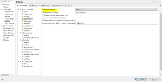

Omar_Anguiano
Hello
When you create a new project with MCUXpresso for a given target you get a linker file, startup code, and CMSIS files. You can find examples and drivers but they cannot be used if you choose.
Additionally, the SDK also contains all the things for the launch configuration and flash programming.
You can optimize the code in properties->C/C++Build->Settings->Optimization
If you have more questions do not hesitate to ask me.
Omar
