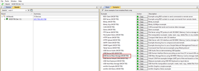

Hi everyone,
    I am working with LPC1768 and now i need to use this device as USB Mass Storage, connect it to a computer and see files stored in a SD card with SPI interface. I am new using the USB Interface for this type of application, then first of all, is it possible to do that? what i must read or there are some examples to check? I am attentive to your comments.
Best Regards.
1,600 Views
FelipeGarcia
For the USB mass storage device example you can take a look to the Keil MDK software package for the MCB1700 Board which includes an example of this.
 Also, I recommend you to check AN11070 that describes how to use the SPI/SSP interface on the LPC1700 family MCU to access Secure Digital Card (SDC) or Multi Media Card (MMC).
Hope it helps!
Felipe
