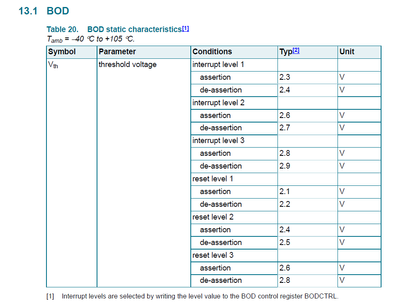

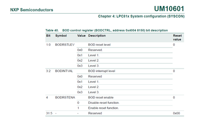

wwz
Thanks for the quick response, i have found the problem, it is caused by an external reset chip.but i have another quesiton: for the BOD reset level 0, LPC812 has no description of reset level 0 ,but LPC824 has the description of reset levle 0,Is it the same as LPC824?

xiangjun_rong
I suppose that there is not reset level 0 for both LPC82x and LPC81x, there are Reset level 1,2,3, which corresponds to different Reset threshold voltage.
For LPC81x:
The corresponding threshold voltage for LPC81x is defined in data sheet of LPC81x:
Hope it can help you
