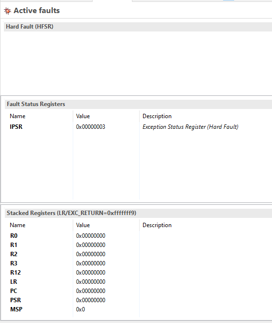

I am trying to use the M0APP with multicore programming on the LPC4370. The M4 project activates the M0APP project as expected but I am now getting a hard fault SystemCoreClockUpdate() function. I debugged and saw the problem specifically happens inside the Chip_Clock_FindBaseClock() function.
Does anyone have any suggestions to solve this problem?
Is there a guide to understanding hard faults?

Hello @smarty760
About "Hard Fault", you can have a look at:
https://www.keil.com/appnotes/files/apnt209.pdf
https://mcuoneclipse.com/2012/11/24/debugging-hard-faults-on-arm-cortex-m/
It seems the issue on your case is clock, recommend you check clock configuration, and also test demo under LPCopen first.

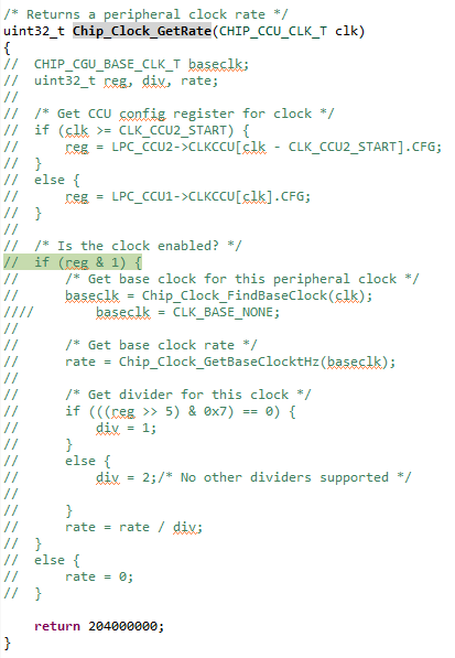

I have tried the "multicore_blinky_m4", "multicore_blinky_m0app" and other similar similar examples posted on the forums and I never got a clock problem. I would insert my code into the example and after I try to debug this, the clock becomes an issue.

Hello @smarty760
1) Yes,  Clocks Tool  doesn't support legacy products lpc43xx.
2) "I tried commenting out the code in the Chip_Clock_GetRate() but, when debugging with stepping line by line, the function is still being debugged as if it was not commented out."
->> There is issue in your project. Delete .metadata folder under MCUXpresso IDE workspace,  then re-compile and debug your project again.  Also can create a new project or development based on example under LPCopen.

The SystemCoreClockUpdate() is in the first line of code in the main. Even if I commented this out the Chip_Clock_GetRate() within the SystemCoreClockUpdate() code is called in other parts of the code. Maybe it is worth mentioning that the code im trying to copy worked on the lpc43S67 instead of the lpc4370 I am working on now. However, I am not sure how the first line of code in the main would be affected by the code that is used after it in the debug session.
This is usually a sign that your project setup or debug setup is incorrect or corrupted.
Perhaps it is just out of sync, and a clean/rebuild helps. Because Eclipse projects tend to be somewhat opaque and messy, I often end up creating a fresh project.
Try a simple test here: insert a line containing "#error <some text>" in the source file, and rebuild.
If it doesn't throw an error, you probably have multiple copies in your project.
