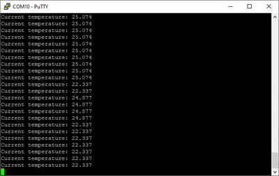

After those changes the example still worked correctly (although temperature measurement needs some additional work, as there is a lot of digital noise due to low resolution of the vbe ADC values, but that's another topic):

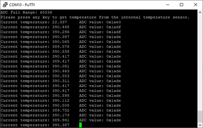

This is what I get:
As you can see the first temperature result looks OK, but after that it's way off.
(I didn't check the ADC0_0 result, but that also looks off, as nothing is connected to the pin yet)

However, I found that the internal temperature measurement can take about 4500 cycles (CPU running at 96MHz and ADC clock of 4MHz).
I suppose this is probably because of the hardware averaging used by the internal temperature measurement (we do not do HW averaging on the normal ADC measurements).
So the conversion while loop for the internal temp measurement was aborted due to the timeout, but the FIFO was later on still filled with the temperature values (vbe1/vbe8).
And those values ended up later on when the normal ADC channel measurement is triggered.
I now fixed it by increasing the timeout max to 10000.
