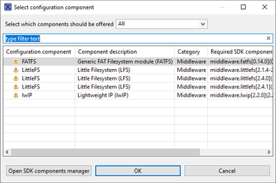

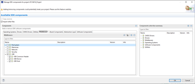

@Kris_Ke How did you add USB0 in the middleware?
This is what I get when I click on "+ green" button for middleware.
This is what I have in manage SDK components.
I am using custom board with lpc54016 and trying to configure USB as USBHID but it keeps coming as "Universal serial bus device", I think it might be because I didn't configure USB in my software right. But I am not sure.
