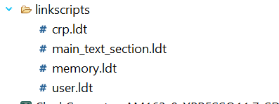

 I think maybe there is issue with the linker file of application project. While project can not build well on my side, so I don't know which linker file do you used. Use IDE to config? Or use the files under linkscripts folder?

I am so sorry, but from my side both project compile well with MCUXpresso. I tried different PC to check it.
For the application project, I am using the linker file inside the folder of your screenshot. When I compile for using the application without the bootloader I am using the configuration without the _BOOT at the end, instead when I compile the application project to put it on the specific part where the bootloader jump I am using the configuration with _BOOT at the end.
