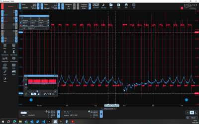

 I am controlling a bldc motor with 3 sct ouptuts. This works fine until one of the thrree duty cycles reach 50-60%. After this point strange things happen and it might be that pulses get missing (see attached red curve) The SCTIMER_UpdatePwmDutycycle function is called every 50us. (PWM Frequency is 20kHz). If I increase the frequency to 50kHz it gets even worse. If I choose frequency 10kHz it gets better but this frequency is not suitable for my application.

I managed to resolve this issue by commenting the update of MATCH register and just update the MATCHREL register
