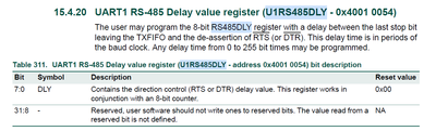

We want to use LPC1765 UART1 as RS485 interface and let the HW manage the TX/RX enable line
When we connect it to a PC via RS485-USB interface, using PC terminal  we can transmit and recive and its working fine.
When we try to connect it to another device,  the other device does not recognize our communication, even though the data is received.
We changed the interface from RS485 UART to simple UART + GPIO for TX/RX enable line and it works ok.
Any idea what can be the cause?
We see timing differences between the 2 communications configurations but since it is working with the PC with both of them, it seems that HW or configuration is not an issue.

As you said that RS485 UART can communicate to PC with or without GPIO, it means the software/hardware are okay. But the RS485 UART can not communicate to another device.
1)Pls check the baudrate, if you reduce the baud rate, it is okay? I means that the bit width of  uart and another device uart must match.
2)Pls try to add a delay
Hope it can help you
