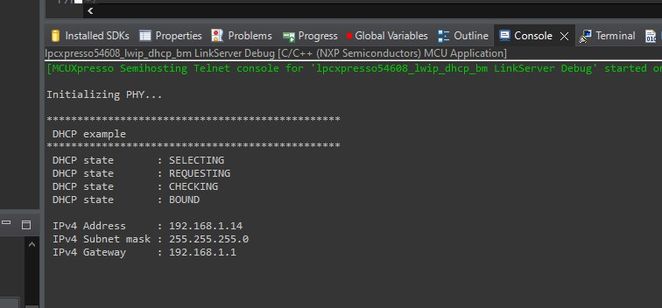

Here after the terminal screenshot of the example DHCP code from SDK running from 0x00 (good working)

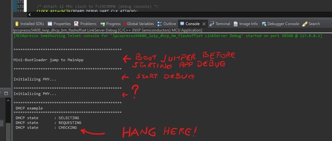

and here after the terminal screenshot of the example DHCP code from SDK running from 0x10100 (not working, it hang in the checking state)

Here after the terminal reports when I enable the DHCP and UDP lwip debug options in lwipots.h
[MCUXpresso Semihosting Telnet console for 'lpcxpresso54608_lwip_dhcp_bm_flashoffset LinkServer Debug' started on port 50496 @ 127.0.0.1]
Mini-Bootloader jump to MainApp
Initializing PHY...
dhcp_start(netif=0x20027fb4) en0
dhcp_start(): mallocing new DHCP client
dhcp_start(): allocated dhcp
dhcp_start(): starting DHCP configuration
udp_bind(ipaddr = 0.0.0.0, port = 68)
udp_bind: bound to 0.0.0.0, port 68)
udp_connect: connected to 0.0.0.0, port 67)
dhcp_discover()
transaction id xid(abcd0001)
dhcp_discover: making request
dhcp_discover: sendto(DISCOVER, IP_ADDR_BROADCAST, WIP_IANA_PORT_DHCP_SERVER)
udp_send: added header in given pbuf 0x200001a0
udp_send: sending datagram of length 316
udp_send: UDP packet length 316
udp_send: UDP checksum 0x724f
udp_send: ip_output_if (,,,,0x11,)
dhcp_discover: deleting()ing
Initializing PHY...
dhcp_start(netif=0x20027e84) en0
dhcp_discover()
dhcp_discover: SELECTING
dhcp_discover(): set request timeout 2000 msecs
 DHCP example
udp_input: received datagram of length 310
UDP header:
|        67     |        68     | (src port, dest port)
|       310     |     0xa496    | (len, chksum)
udp (192.168.1.14, 68) <-- (192.168.1.1, 67)
pcb (0.0.0.0, 68) <-- (0.0.0.0, 67)
udp_input: calculating checksum
dhcp_recv(pbuf = 0x20009d1c) from DHCP server 192.168.1.1 port 67
pbuf->len = 302
pbuf->tot_len = 302
skipping option 2 in options
skipping option 6 in options
skipping option 12 in options
searching DHCP_OPTION_MESSAGE_TYPE
DHCP_OFFER received in DHCP_STATE_SELECTING state
dhcp_handle_offer(netif=0x20027e84) en0
dhcp_handle_offer(): server 0x0101a8c0
dhcp_handle_offer(): offer for 0x0e01a8c0
dhcp_select(netif=0x20027e84) en0
udp_send: added header in given pbuf 0x20000324
udp_send: UDP checksum 0x86e4
dhcp_select: REQUESTING
dhcp_select(): set request timeout 2000 msecs
UDP header:
|       310     |     0x2d8f    | (len, chksum)
dhcp_recv(pbuf = 0x20009d5c) from DHCP server 192.168.1.1 port 67
pbuf->len = 302
pbuf->tot_len = 302
UDP header:
|       310     |     0x2a8f    | (len, chksum)
dhcp_recv(pbuf = 0x20009d7c) from DHCP server 192.168.1.1 port 67
pbuf->len = 302
pbuf->tot_len = 302
DHCP_ACK received
dhcp_check(netif=0x20027e84) en
dhcp_check(): set request timeout 500 msecs
DHCP state       : CHECKING
After this it can't complete the CHECKING state, so it can't BOUND and complete the dhcp process.
Is there something wrong on relocating the SDK dhcp example (and lwip library) at flash address different from 0x00? I'm missing some memory definitions for lwip? Are there some structures in lwip stack that should be manually relocated in memory or flash?
