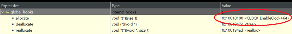

After some more research I discovered that somehow the global hook function pointer for malloc inside the cJSON lib got overwritten. I do not know why, yet. Calling the cJSON_init(NULL) right before calling CJSON_CreateObject() fixes the problem for now.
Ron
