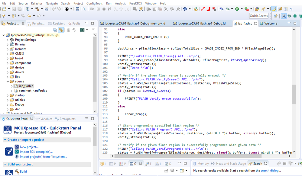

Regarding the error when you program flash, I suggest you download SDK for LPC55S6x from the link:
MCUXpresso SDK | Software Development for Kinetis, LPC, and i.MX MCUs | NXP
In the package, there is example to erase/program flash as the following fig, I suggest you try to run the example.
Hope it can help you
XiangJun rong
