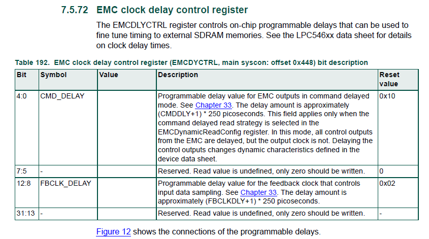

Higher values for CMD_DELAY and FBCLK_DELAY ?
I use 0x1010 on 54608 running at 180 MHz and EMC at 90 MHz. I use the same value on projects with the 54628 running at 200 MHz and EMC at 100 MHz. This does not mean that it is a "universal value" that works for all. I could also be something else with the design/setup.

in all my designs with 54608, 54628 and SDRAM (and also on the NXP eval board!) I need to add:
SYSCON->EMCDLYCTRL = 0x1010; // Handles EMC clock=90 MHz !!!
to get the SDRAM to work properly.

Have you tried with even more conservative values in this register ?

xiangjun_rong
Hi, Gaston,
pls try to adjust the setting of the EMC clock delay control register and check if you get improvement as Garsten said.
