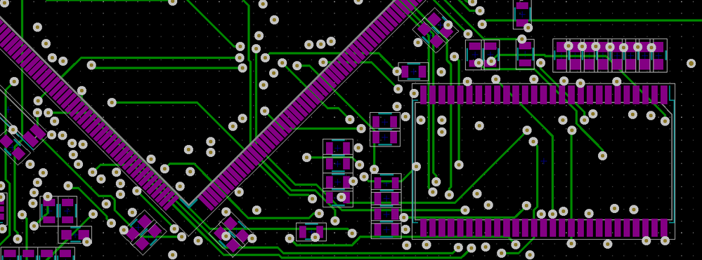

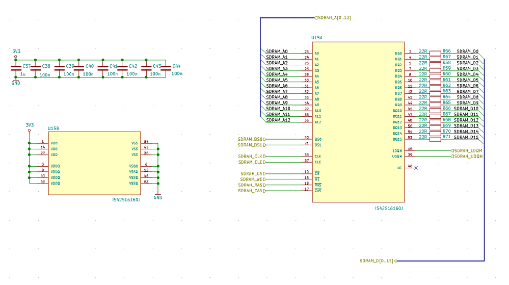

I've designed a custom board with LPC54608J512BD208 and IS42S16160J-7TLI following the OM13098 schematics (RevF) as a reference. Here's my current SDRAM connection

At the end I have come to the conclusion that the PCB design (routing, stack-up) is not very suitable for the required SDRAM speeds. I will have to redo the design prioritizing this point.

Regarding the issue that you write address[0]=0xaaaaaaaa, but you read as 0xaa2aaa2a, obviously, the D7 is read as 0 which should have been 1. I think it is a hardware issue, for high speed SDRAM access, you have to consider the signal integrity, in other words, 4 layers board, all data bus pins should connect to a serial resistor which locates as close as possible to the SDRAM data bus. BTW, if you decrease the SDRAM clock frequency, what is the result?

Hi Xiangjun, I'm not sure is a Harware issue.The design includes a 4-layer PCB (one internal layer as solid GND) and the distribution is close enough (I hope) with the 22R resistors connected to the data bus.
