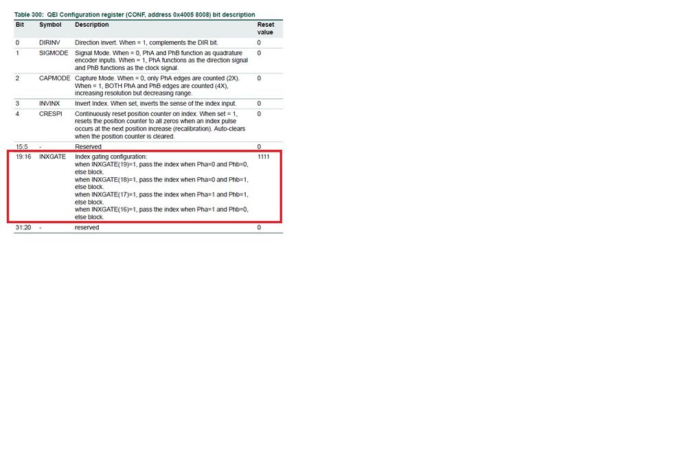

INXGATE.jpgINXGATE lead to  INXCNT can not count independently , when endcoer A / B is stop.
please try it ......and give me some clear answer.
YES ->  how  to set ?
NO -> NXP  not suppurt.

xiangjun_rong
Hi, Yansin,
I suppose that Index Counter counts only Index signal from the IDX pin even if A/B signals stop. If you connect a low frequency clock signal to IDX pin, then check the Index counter in debugger, does it change or not?
XiangJun Rong

xiangjun_rong
Hi, Yansin,
Your issue is that you can not generate interrupt when you send pulse to the QEI_IDX pin, if you set the INX_EN bit with your code:LPC_QEI->IES = ((uint32_t)(1 << 0)); I think the interrupt can be triggered.
But as a workaround, I think you can use software interrupt to solve the problem, in other words, you do not need to send pulse to QEI_IDX pin, but the void QEI_IRQHandler(void) can be executed.
After you call NVIC_SetPendingIRQ(QEI_IRQn);, the QEI interrupt will be triggered.
