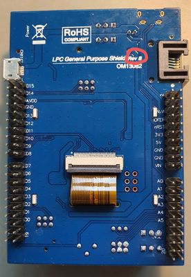

On Revison B boards the documentation (UM10940) states:
3.4
Boards from revision B onward include a FET placed in-line with the VDD connection to the SD/MMC card slot (see Section 4.7). Revision B and later boards have revision printed on the silkscreen on the underside of the board near the board name; revision A boards do not have the revision shown.
4.7
On revision B and later boards there is a FET placed in-line with the VDD connection to the SD/MMC card slot. This enables the power to this peripheral to be controlled using a GPIO connection from pin 1 of CN8 LPC GP Shield.

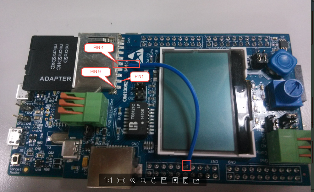

    I found the OM13082 general purpose board didn't connect the SD card pin 4 to the VDD.
    So, please add a wire between your OM13082 general purpose board  SD card pin 4 to VDD,  you also can check the SD card pin 4, whether it has 3.3V after you connect the board to your LPCXpresso LPC43S67 board.
   Now, I modify my board,  and test the lpcopen periph_sdmmc example which download from this link:
LPCOpen Software for LPC43XX|NXP
  After insert a SD card, I can create the hello.txt successfully.
 1. Solid a wire between SD pin 4 to 3.3V like this picture:
SD PIN4->CN7_12

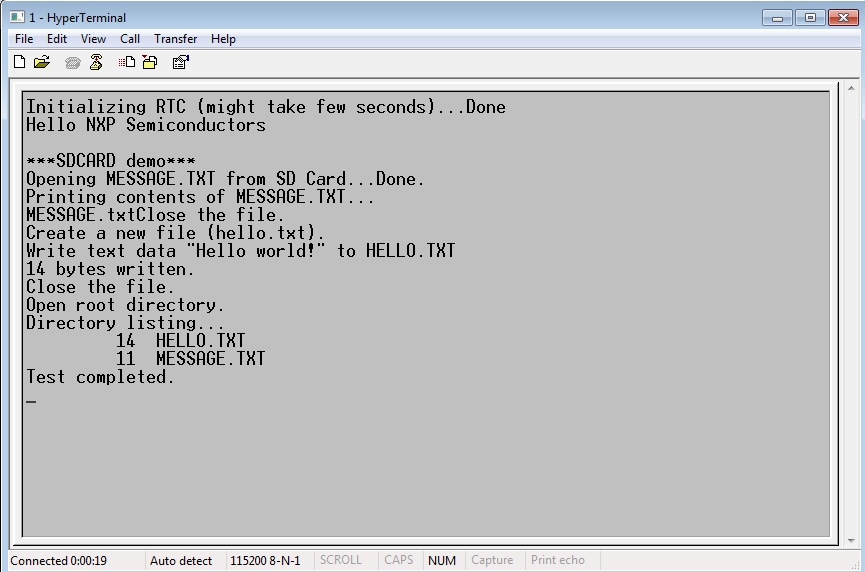

3. These are the printf in the com from my side:
After running the code, you will find there has a HELLO.text file in the SD card.
Please follow my step, and do it again.

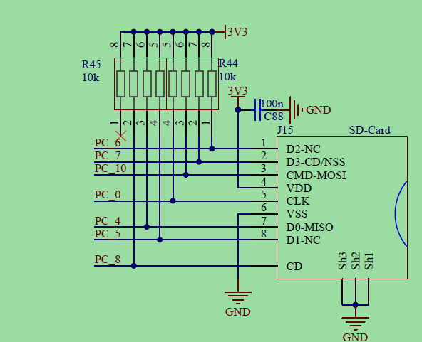

BTW, if in your own SD card design, for the stable working, I suggest you add the external 10K pull up in the SD card pin like the mini card circuit in the MCB4357 board:
