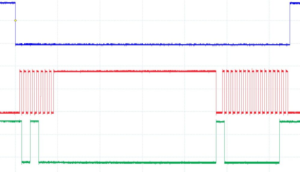

Hi All,
I'm looking to interface to a slightly non standard spi interface using a 9bit address word as shown below to make a 17 or 25 bit total frame size.
In the LPC546xx manual (section 26.2) I see larger frame sizes beyond 16bits are supported by software. Are there further details on how this can be achieved? As I'd still have to interface to the 8 bit fifo's.

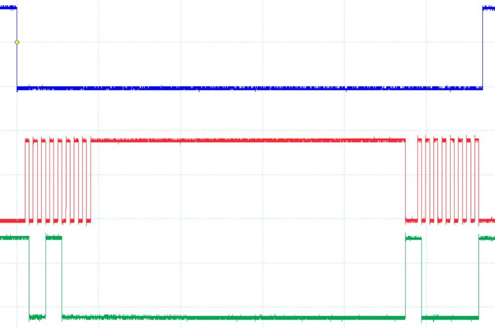

iann
Thanks Alexis, that's the missing piece I needed.
To close this off now, my waveforms now are
17bits
and 25bits
Cheers
Ian
