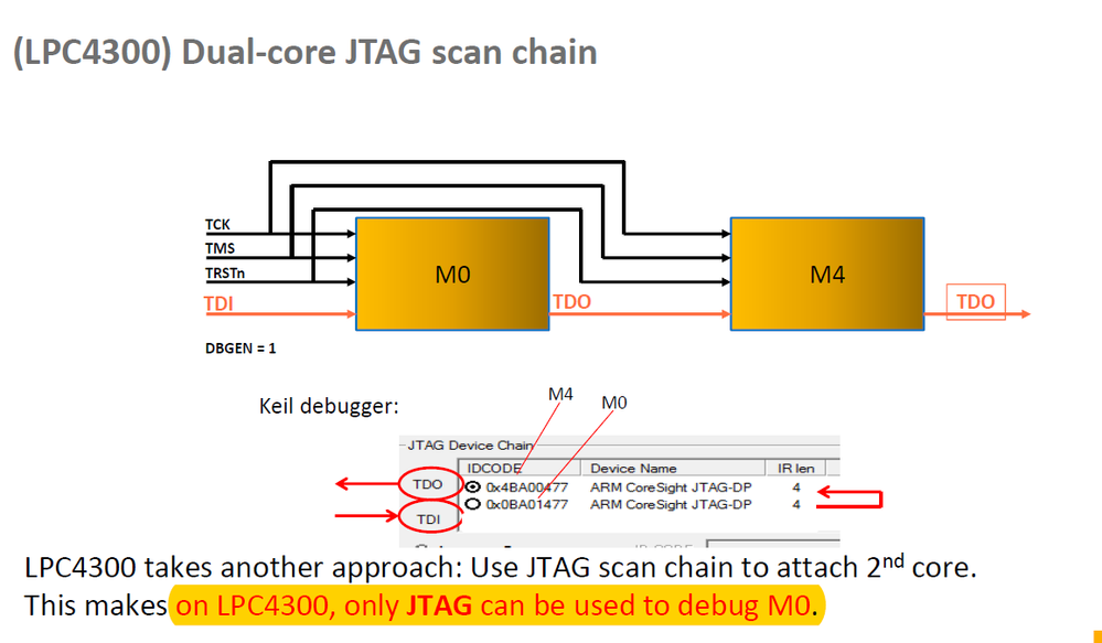

Hi Ravi thakur,
   What the debug interface you are using?
   Please check this picture:
If you want to debug the M0, you need to use JTAG, SWD will have problems.
Wish it helps you!
Kerry

I am following the video posted below to generate and debug the multicore project. The multicore flow is talked about from 29:00 onward. I am selecting jtag when I debug. I have to step in to the function "cr_start_m0(SLAVE_M0APP,&__core_m0app_START__)" every time and even then it is not guaranteed that the code reaches the m0 core main. I have "M0_SLAVE_PAUSE_AT_MAIN" defined in the project, expecting the execution to halt in the m0 main, but that doesn't happen majority of the time.
