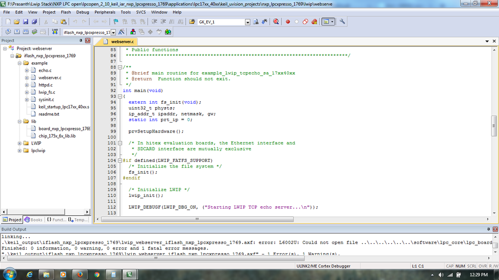

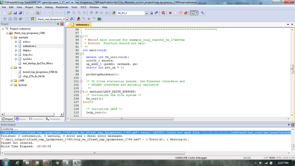

prasanthapplied
I getting this problem solved by after moving the "board" and "chip" library files to some other location and than add it to a project.
It's working fine now.

prasanthapplied
   Sorry for late response.
   I tried "webserver" example from your suggested example projects. But while build the project i getting an error for both 2_07 and 2_10 versions.          I attached a screenshot to it.
I don't know how to solve this problem. Please help me to solve it.
