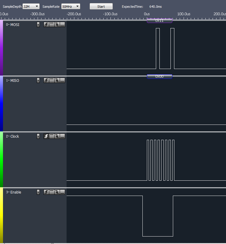

I am writing a spi flash driver. One of the first things I have to do before writing is send a write enable command. Here is the code.
IO_SetPinState(SPI_CSPort, SPI_CSPin, false);
delayUS(1);
Chip_SSP_SendFrame(LPC_SSP1, WRITE_ENABLE);
while (Chip_SSP_GetStatus(LPC_SSP1, SSP_STAT_BSY) == SET);
IO_SetPinState(SPI_CSPort[1], SPI_CSPin[1], true);
Since the driver was not working, I set a breakpoint after this. I noticed that two bytes were output.
The waveform I previously attached was generated with the program stopped at the breakpoint and just writing 0x3A to the SSP1->DR register, so I am sure no other byte was written.
These are the Register settings.

kerryzhou
Hi Raymundo,
    Please refer to our LPCopen ssp sample code, it also configure the data as 8bit.
   I have test this code, it works ok on my side, when I just send one byte data, you can download the code from this link:
http://cache.nxp.com/files/microcontrollers/software/LPCWare/lpcopen_2_12_lpcxpresso_nxp_lpclink2_43...
  Find the SSP code in folder:lpcopen_2_12_lpcxpresso_nxp_lpclink2_4370\periph_ssp
  I modify these points:
1. #define BUFFER_SIZE                         (0x1)
2. add   Tx_Buf[0] =0X55; in static void appSSPTest(void) like this:
    int key;
    DEBUGOUT(sspTransferModeSel);
    dmaChSSPTx = Chip_GPDMA_GetFreeChannel(LPC_GPDMA, LPC_GPDMA_SSP_TX);
    dmaChSSPRx = Chip_GPDMA_GetFreeChannel(LPC_GPDMA, LPC_GPDMA_SSP_RX);
    xf_setup.length = BUFFER_SIZE;
    xf_setup.tx_data = Tx_Buf;
    xf_setup.rx_data = Rx_Buf;
    while (1) {
        key = 0xFF;
        do {
            key = DEBUGIN();
        } while ((key & 0xFF) == 0xFF);
        Buffer_Init();
        Tx_Buf[0] =0X55;
After testing , the result is like the following picture, it only sends one byte.
so, please refer to the lpcopen sample code, check your own configuration and calling again.
Wish it helps you!
If you still have question, please let me know!
Kerry

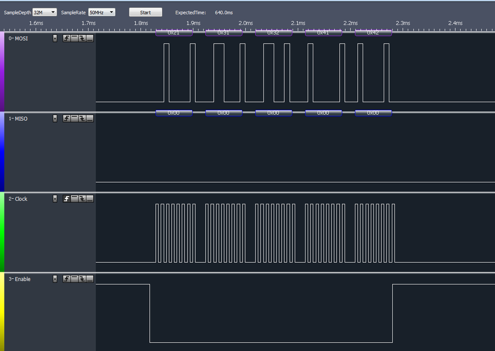

12,939 次查看

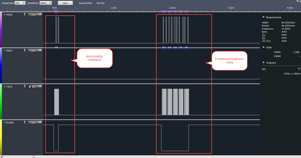

kerryzhou
Hi Raymundo,
  Actually, my above reply is just based on the polling mode.
  Now answer your question in details.
   Because the SSEL will be controlled by the SSP module, then this pin will pull up after each byte sending.
   Now, if you want to control the SSEL pin freely, you can configure this pin as the GPIO, then use the software to control it.
   I have modify the SSP code which can realize your function, for simply showing, I modify your demand like this:
SSEL on
send write enable (1 byte 0x11) command
SSEL off
SSEL on
send program command(0x21)
send address (2bytes: 0x31,0x32)
send data (2bytes: 0x41,0x42)
SSEL off
  If you want to have different bytes, just change the number.
 Then the test result wave from logic analyzer are like this:
zoom in:
Because I didn't add the SPI slave, the MISO don't have the data, but the Master polling control are sending the data which you want.

You can find my clk frequent is about 6Mhz, actually, I also use the oscilloscope test it, it is really 6Mhz, the logic analyzer have little allowable errors.
This is my configuration:
     ssp_format.frameFormat = SSP_FRAMEFORMAT_SPI;
     ssp_format.bits = SSP_DATA_BITS;
     ssp_format.clockMode = SSP_CLOCK_MODE0;
    Chip_SSP_SetFormat(LPC_SSP, ssp_format.bits, ssp_format.frameFormat, ssp_format.clockMode);
    LPC_CGU->BASE_CLK[CLK_BASE_SSP1] = 0x1000800;
    LPC_SSP1->CR0 = 0X07;
    LPC_SSP1->CPSR =0X02;
     Chip_SSP_Enable(LPC_SSP);‍‍‍‍‍‍‍‍‍‍‍‍‍‍‍‍
2. 8 frames lag
  I also transfer 8 frames(Bytes), no lag:
Code:
          xf_setup.length = 8;
               Tx_Buf[0]=0x21; // one byte program command
               Tx_Buf[1]=0x31;// two bytes address
               Tx_Buf[2]=0x32;// two bytes address
               Tx_Buf[3]=0x41; // two bytes data
               Tx_Buf[4]=0x42;// two bytes data
               Tx_Buf[5]=0x43; // two bytes data
               Tx_Buf[6]=0x44;// two bytes data
               Tx_Buf[7]=0x45; // two bytes data
                         xf_setup.rx_cnt = xf_setup.tx_cnt = 0;
                         Chip_GPIO_SetPinState(LPC_GPIO_PORT, 7, 19, 0);
                         Chip_SSP_RWFrames_Blocking(LPC_SSP, &xf_setup);
                         Chip_GPIO_SetPinState(LPC_GPIO_PORT, 7, 19, 1);‍‍‍‍‍‍‍‍‍‍‍‍‍‍‍‍‍‍‍‍‍‍‍‍‍‍‍‍‍‍‍‍
Test result:
From now on, I didn't reproduce your problem.
So, for the time saving, you'd better give me your test project, it is useful to me to find your root problem, or you can compare my configuration with your project, find what the difference between our configuration.
I think there still missing some information.
Kerry

As I mentioned earlier the PLL is disabled, so I am getting the clock directly from the crystal.
Also, in the signal image I posted you can see the horizontal grid is set to 400nS per division and 6 clock cycles take 2.5 divisions so it is 1000nS for 6 clock cycles which translates to 6Mbps.
The only other difference I see is that the LINK2 board has the LPC4320 and we are using LPC4370 in our project.

Ray_V
Contributor V
I just attached a simple project where I get the problem I described.
As it is, it outputs 2 bytes instead of 1.
If you uncomment line 26 in board_spi.c it outputs one byte, but lagging by 8 frames. First 8 frames are 0x00 then it starts output of my data 8 frames behind.
Thanks in advance for your help.
12,939 次查看
