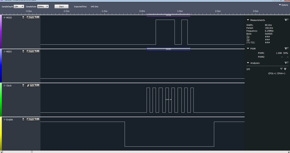

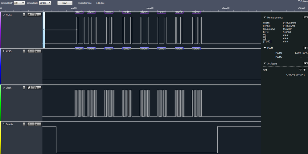

I am implementing SPI on LPC4370 SSP. I have configured for 8-bit frame.
However when I write to the DR register it outputs 16 bits, the first byte seems to be what was entered 8 frames ago and the second byte is what I just entered.
Is this a known problem with a workaround?
or is something configured wrong?
CCR0 = 0x07,
CCR1= 0x02

My test result is:
   Actually, I also try other clock source, just make sure the peripheral clock is not larger than register clock, the data is correct, and have no lag.

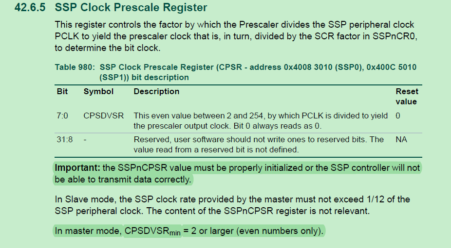

I tested several settings and it seems that the output of the SSP prescaler has to be a value that corresponds to the SSP Register Clock  divided by an even number(Possible CPSR value).
For example I did not change my clock settings (MCU + SSP Register Clock = 2MHz, and SSP peripheral clock = 12MHz), but used CPSR = 12 (output 1MHz achievable by 2MHz/2), CPSR = 24 (Output 500KHz achievable by 2MHz/4) and CPSR = 36 (Output 3331/3KHz achievable by 2MHz/6) and they all work.
However CPSR = 16 (750KHz not achievable by 2MHz with any CPSR setting) does not work.
So apparently, the only way to guarantee that the settings work is to have the SSP peripheral clock be the same as the SSP registers clock. It is probably related to the fact that the data is set through the DR register running at the register clock rate. This defeats the advantage of being able to specify different peripheral and register clocks.

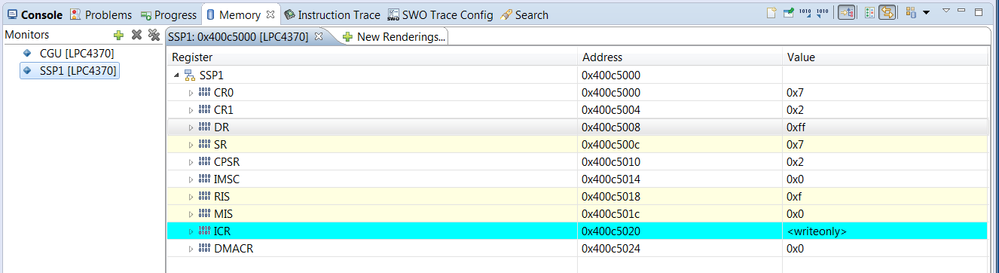

I am writing a spi flash driver. One of the first things I have to do before writing is send a write enable command. Here is the code.
IO_SetPinState(SPI_CSPort, SPI_CSPin, false);
delayUS(1);
Chip_SSP_SendFrame(LPC_SSP1, WRITE_ENABLE);
while (Chip_SSP_GetStatus(LPC_SSP1, SSP_STAT_BSY) == SET);
IO_SetPinState(SPI_CSPort[1], SPI_CSPin[1], true);

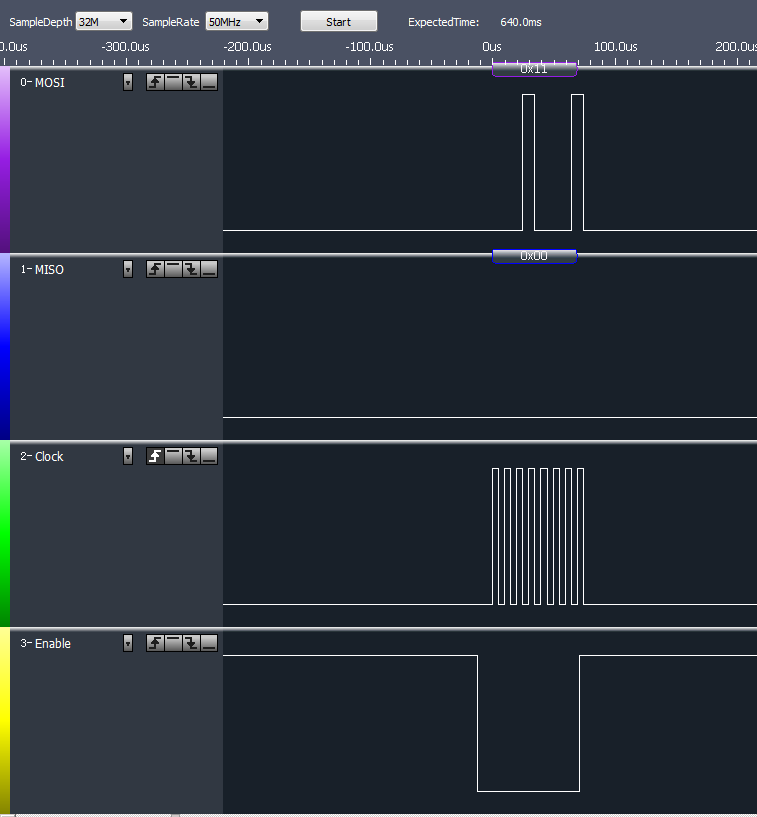

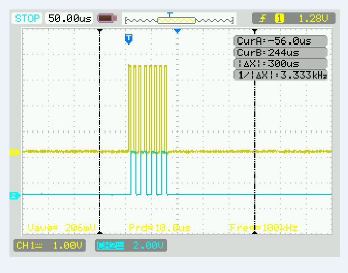

Since the driver was not working, I set a breakpoint after this. I noticed that two bytes were output.
The waveform I previously attached was generated with the program stopped at the breakpoint and just writing 0x3A to the SSP1->DR register, so I am sure no other byte was written.
These are the Register settings.

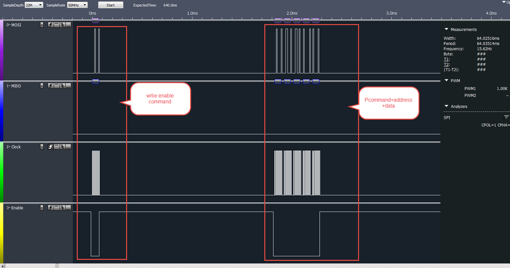

kerryzhou
Hi Raymundo,
  Actually, my above reply is just based on the polling mode.
  Now answer your question in details.
   Because the SSEL will be controlled by the SSP module, then this pin will pull up after each byte sending.
   Now, if you want to control the SSEL pin freely, you can configure this pin as the GPIO, then use the software to control it.
   I have modify the SSP code which can realize your function, for simply showing, I modify your demand like this:
SSEL on
send write enable (1 byte 0x11) command
SSEL off
SSEL on
send program command(0x21)
send address (2bytes: 0x31,0x32)
send data (2bytes: 0x41,0x42)
SSEL off
  If you want to have different bytes, just change the number.

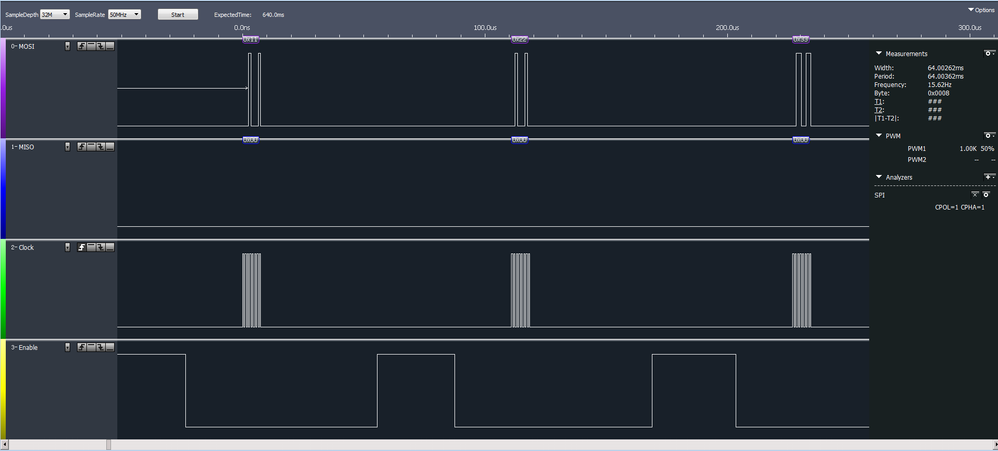

 Then the test result wave from logic analyzer are like this:
zoom in:
Because I didn't add the SPI slave, the MISO don't have the data, but the Master polling control are sending the data which you want.
My polling function is like this:

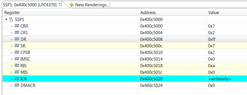

Do you see any problem with my initialization?
Can you post the SSP register settings you have when you get the above results?
13,202 Views
kerryzhou
HI Raymundo,
   My configuration is the same as you, except the SSP clock divider, but this should not influence the SPI send bit.
   Your configuration is already 8 bit.

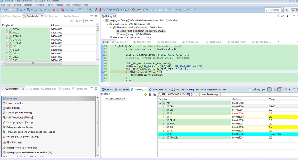

   This is my register result after 0X3a:
Could you please send me your whole project?
I will check your project on my side.
Kerry

Ray_V
Contributor V
I agree, it shouldn't but it does.
To reduce power consumption I am running with PLL disabled clock directly from crystal (12MHz)
So Pre-scaler is set to 2 (lowest value) and the SCR bits in the CR0 register are set to 0 (1 pre-scaler clock per bit) this should allow me to run at a 6MHz bit-rate.
With this configuration I have the problem as described. Once I change the SCR bits to anything other than 0 the problem disappears.
Now my problem is that the byte it outputs is the byte written 8 frames ago. So I have to write 8 frames before I assert the chip select (it outputs 0xFF for the first 8 frames, no matter what I write to the DR register) and then I have to write 8 "dummy" frames afterwards to output all the frames that I want to send.
In short, the data output lags by 8 frames.

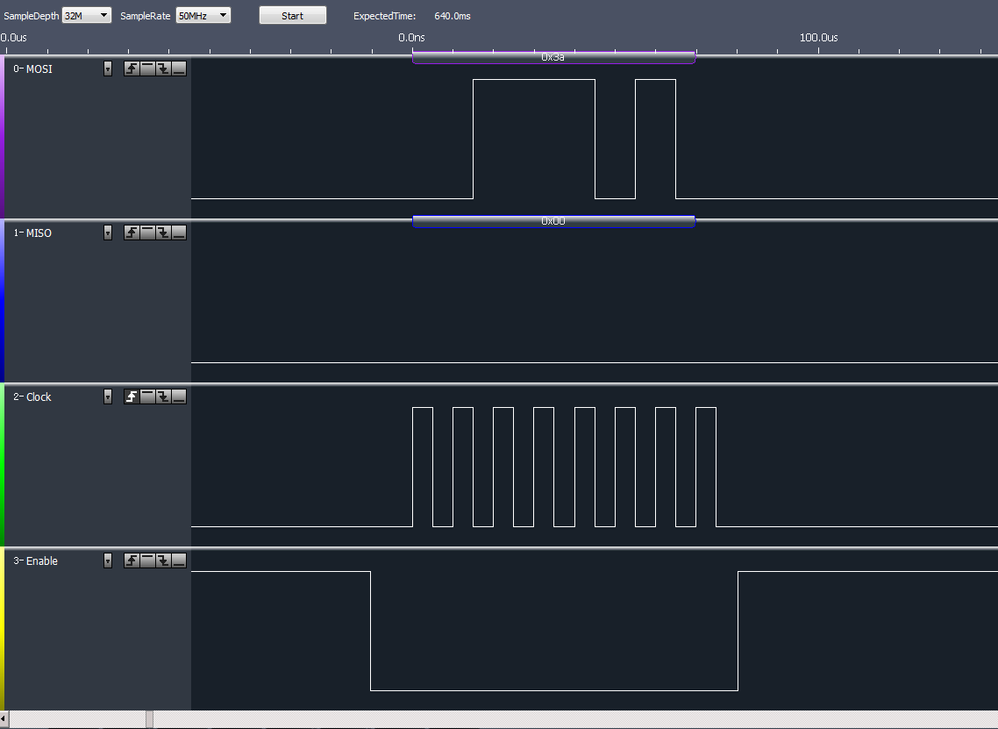

kerryzhou
Hi Raymundo,
     Thank you for your more details.

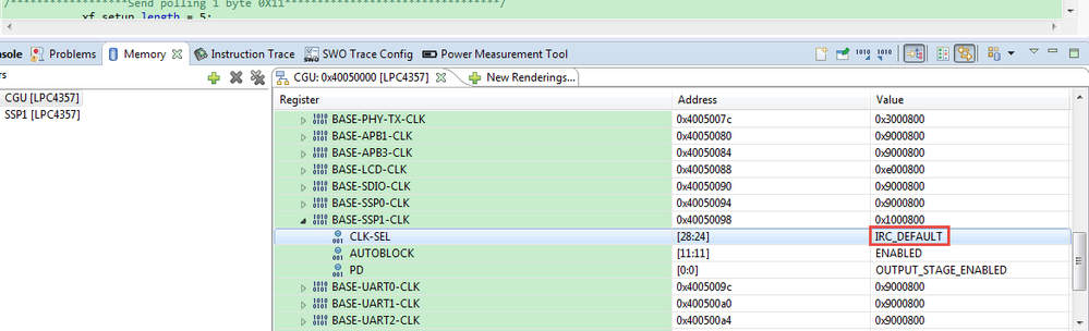

1. Clock source factor.
   I also tried the 12Mhz as the SSP1 clock source,  and configure SCR =0, CPSR=2.
  I still can get the correct data, the ssp baud rate is 6Mhz.
  Did you check your ssp baud rate, whether it is 6Mhz? I can't get the data from your picture.
  Please also check the register: CGU->BASE-SSP1-CLK,
  This is my test result:
You can find my clk frequent is about 6Mhz, actually, I also use the oscilloscope test it, it is really 6Mhz, the logic analyzer have little allowable errors.
This is my configuration:
     ssp_format.frameFormat = SSP_FRAMEFORMAT_SPI;
     ssp_format.bits = SSP_DATA_BITS;
     ssp_format.clockMode = SSP_CLOCK_MODE0;
    Chip_SSP_SetFormat(LPC_SSP, ssp_format.bits, ssp_format.frameFormat, ssp_format.clockMode);
    LPC_CGU->BASE_CLK[CLK_BASE_SSP1] = 0x1000800;
    LPC_SSP1->CR0 = 0X07;
    LPC_SSP1->CPSR =0X02;
     Chip_SSP_Enable(LPC_SSP);‍‍‍‍‍‍‍‍‍‍‍‍‍‍‍‍
2. 8 frames lag
  I also transfer 8 frames(Bytes), no lag:
Code:
          xf_setup.length = 8;
               xf_setup.tx_data = Tx_Buf;
               xf_setup.rx_data = Rx_Buf;
               Tx_Buf[0]=0x21; // one byte program command
               Tx_Buf[1]=0x31;// two bytes address
               Tx_Buf[2]=0x32;// two bytes address
               Tx_Buf[3]=0x41; // two bytes data
               Tx_Buf[4]=0x42;// two bytes data
               Tx_Buf[5]=0x43; // two bytes data
               Tx_Buf[6]=0x44;// two bytes data
               Tx_Buf[7]=0x45; // two bytes data
                         xf_setup.rx_cnt = xf_setup.tx_cnt = 0;
                         Chip_GPIO_SetPinState(LPC_GPIO_PORT, 7, 19, 0);
                         Chip_SSP_RWFrames_Blocking(LPC_SSP, &xf_setup);
                         Chip_GPIO_SetPinState(LPC_GPIO_PORT, 7, 19, 1);‍‍‍‍‍‍‍‍‍‍‍‍‍‍‍‍‍‍‍‍‍‍‍‍‍‍‍‍‍‍‍‍
Test result:
From now on, I didn't reproduce your problem.

Ray_V
Contributor V
I just attached a simple project where I get the problem I described.
As it is, it outputs 2 bytes instead of 1.
If you uncomment line 26 in board_spi.c it outputs one byte, but lagging by 8 frames. First 8 frames are 0x00 then it starts output of my data 8 frames behind.
Thanks in advance for your help.

kerryzhou
Hi Raymundo,
      Thank you for your patient.
      Because my LPC LINK2 board is broken, then I am porting your code to my MCB4357 board. The SPI module in LPC4357 is the same as LPC4370.
     A good news, I have reproduce your problem on my side.
     The same result as you have said, now If I comment pSSP->CPSR = prescale;, line 129 in ssp_18xx_43.c, the SSP can send out the correct data.
     I am struggling to find the root problem, from the user manual, we can get that improper data in CPSDVSR will cause to transmit data incorrectly.
   I will continue to check why 2 in CPSDVSR  is not correct, any progress I will let you know.
Best Regards
Kerry

Ray_V
Contributor V
I just wanted to add. The waveform was generated after just writing 0x3A to DR register.
