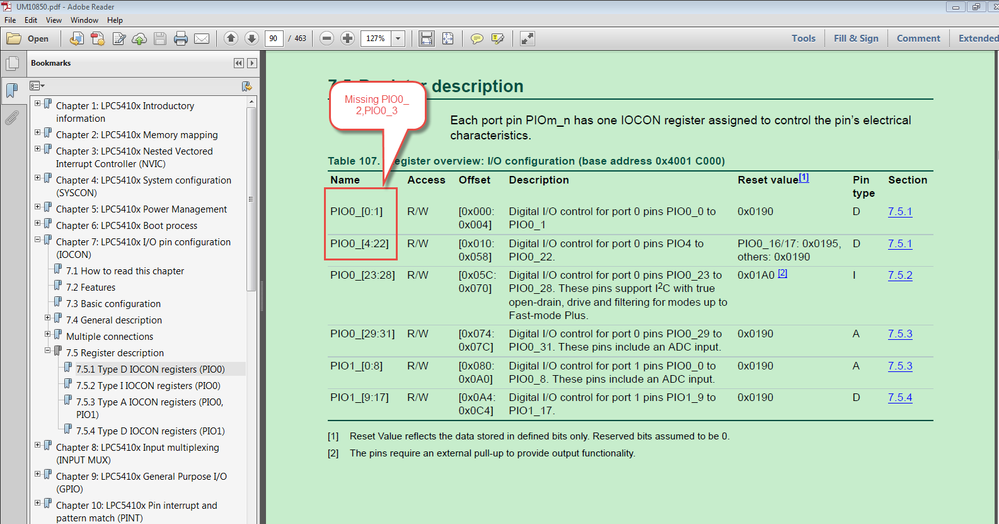

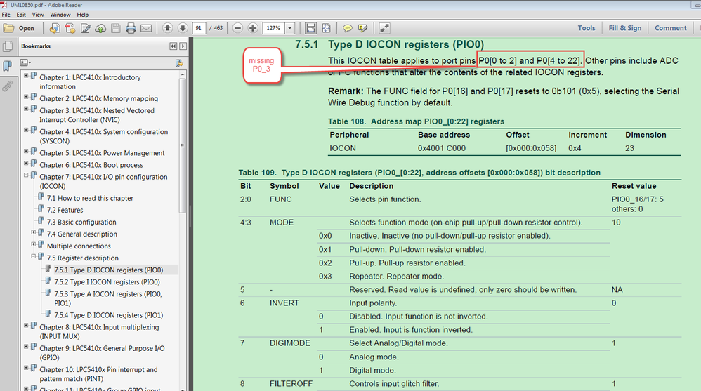

There's another one I noticed. in the IOCON registers section 7.5.1 it says applies to pins P0 0-2 and P0 4-22, what about pin 3. And the same thing in Table 107 but here pins 2 & 3 are missing?

ckphua
On 7.5.1 IOCON register (missing P0_3), I cannot find this issue on the UM10914 dated Sep 26, 2016. Please download the latest UM and post the exact register/page. Thanks

kerryzhou
Hi Chee Kenong Phua,
     Thank you very much for your checking.
     Customer should mentioned UM10850.pdf which is the LPC5410X user manual, the latest user manual really have the problem which Roger mentioned.
    http://www.nxp.com/documents/user_manual/UM10850.pdf?fasp=1&WT_TYPE=Users%20Guides&WT_VENDOR=FREESCA...
1. Page 91.
2. Page 90
Wish it helps you!
Kerry

kerryzhou
Hi Roger,
      Thank you for your highlight.
      That should be also the document content missing problem.
      George already help to report all these doc bugs which you have mentioned, the problem will be fixed in the next doc reversion.
     Thanks  a lot!
Kerry
