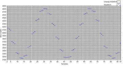

I am trying to run HSADC to 80M on LPC-Link-2.
But I am confusing about it.
When I set the ADC clock as:
Chip_USB0_Init();
Chip_Clock_SetDivider(CLK_IDIV_A,CLKIN_USBPLL,4);
Chip_Clock_SetDivider(CLK_IDIV_B,CLKIN_IDIVA,15);
Chip_Clock_SetBaseClock(CLK_BASE_ADCHS,CLKIN_IDIVB,true,false);
Chip_Clock_EnableOpts(CLK_MX_ADCHS, true, true, 1);
Chip_Clock_Enable(CLK_ADCHS);
The ADC resault will looks like this:
It did not match the 80M sample rate. It looks only 20~30M. And also this is a sine wave. Why does it break and look not like a sine wave? I tried 8M sampling rate. It works great. But if I try to speed up the ADC sample clock it will do like this.

The UART output is partially recognizeable, which suggest the problem is in your code. Especially in the printf (PRINTF() ?) call.
Not sure what you want to ouput there, but I hope you are aware of the bandwidth differences between the ADC and the UART.

But first, it should be clear that you cannot output 120MBps ADC data over a 0,0096Mbps UART channel in realtime. I am pretty sure the LPC4370 has no output channel which can sustain this high data rate in a feed-though manner, you will need to buffer the ADC data in RAM.
Secondly, with a 80Msps rate, internal bus bandwidth can become a problem, and needs at least a consideration. I am quite sure an interrupt-based approach will not work out, you will get ADC overflows immediately. You will need to setup a DMA channel for the number of samples your ADC is supposed to take. I would check the LPC-Link sources, how they do it. Perhaps even use this project as starting point for your project.

But you got 3 consecutive samples, and then a "gap", followed by another 3 consecutive samples - and so on.
A interrupt handler routine to clean out ADC results from a "FIFO half-full" interrupt ?
80 MSPS is a serious number, I think it is illusory to handle that throughput with core involvement.

I had tried both
Chip_HSADC_SetupFIFO(LPC_ADCHS, 8, FALSE);
Chip_HSADC_SetupFIFO(LPC_ADCHS, 8, TURE);
These two settings has same result.
The datasheets wrote it can be 80M. So I guess it's possible. But might need in a perfect condition...
Still finding how to do it right now.
