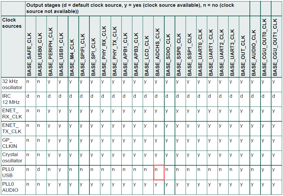

jeremyzhou
Hi Vitaliy Livnov ,
I was wondering if you can illustrate what the behavior of noise which disturbs the HSADC, in further, I'll appreciate if you can upload a compile-able demo code.
And after checking, I find the USBPLL is not the clock source of the HSADC, so it doesn't make sense for the HSADC works well when clock source is the USBPLL, please check it again.
TIC

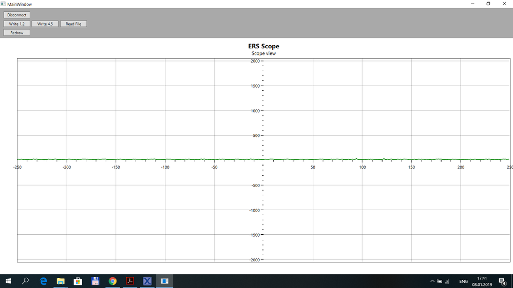

vitaliylivnov
Hello, jeremyzhou. Thanks for your reply. Here is our demo code. We created it in MCUXpresso IDE v10.0.2. You can use USE_PLLAUDIO, USE_MAINPLL and USE_USBPLL defines in scopeFunctional.c to switch HSADC clock source.
We also attach sample graphics at sample rate = 1000 Hz, samples number = 500. ADC input was not connected anywhere.
MAINPLL source.
AUDIOPLL source.
6,430 Views
jeremyzhou
Hi Vitaliy Livnov ,
After reviewing the code, I think the 'phenomenon' is raised by incorrect PLL0_AUDIO configuration.
So I'd like to suggest to follow these below produces to validating the PLL0_AUDIO configuration.
1. Assure fit these features.
2. Output the Fout of PLL0_AUDIO via the CLKOUT pin, and illustrates the output in the oscilloscope.
TIC

jeremyzhou
Hi Vitaliy Livnov,
After reviewing the code, I find the SetUpPLL0audio(100, 15, 1); is not good, even it can achieve the Fout =  Fcco=FINxM/(NxP)= 12x100/(15x1)= 80 MHz.
However, the Fcco=160 MHz, it doesn't fit this requirement: CCO frequency: 275 MHz to 550 MHz.
So I'd like to suggest you can use these paramaters instead the original ones.
SetUpPLL0audio(20, 1, 3); // Fcco = 480 MHz
Please give a try.
TIC
