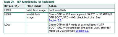

Pls check if the P2_7 is high during/after Reset so that the LPC4357 can boot-up from internal flash.
Hope it can help you
XiangJun Rong
5,746 Views
Jaga123
Yes, P2_7 is pulled high.
