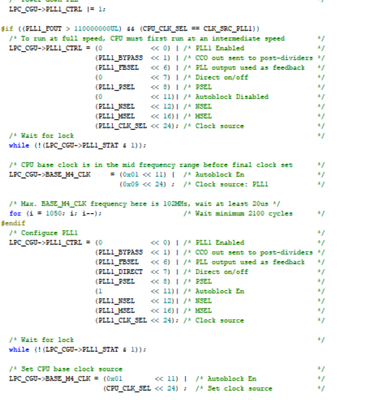

You use 16MHz external clock as the PLL1 input clock, the M is 12, the FCCO is 16*12=192MHz, so the FCLKOUT is 192MHz, I suppose it is okay.
I suppose that PLL1 lock is not implemented, you poll the lock bit, but is it not set, the the code hangs.

Jaga123
Here I attached the PLL1 code part.
I am thinking it is correct. please check the same. If I call this part two times once for PLL1 clock for 144Hz and other for 192 MHz then code is working fine.

Jaga123
I tried to set PLL1 at 160Mhz and it is working fine. But what could be the issue in higher clock settings? we can set clock upto 204Mhz. In some pcb I used same circuit and I am using 192Mhz.
