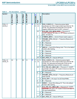

First of all, what is your issue? you did not clarify it in the description.
Can you tell the package of the LPC55S16? do you use PIO0_11 as FC6_SDA pin, PIO0_12 as FC6_SCL pin? If it is the case, do you assign the function in the pin_mux.c with the code like:
Do you connect external pull-up resistor on the SCL and SDA pins?

Hope it can help you
