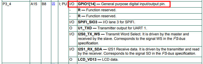

Hi Victor.  Thanks.  That worked !!  Working code for GPIO3_4 (pin on J9 on LPC-Link2).
It makes more sense now than it did a week ago.
One thing, I had to change the example from FUNC_4 to FUNC_0.
I haven't found a reference to what this setting does.
Any ideas?

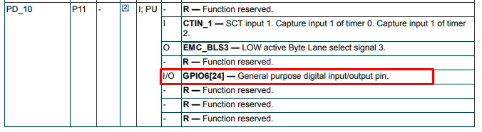

victorjimenez
Hi Simon Prentice,
Please reference the user manual https://www.nxp.com/docs/en/user-guide/UM10503.pdf  chapter 16: Pin Configuration.
In the example of the community post that I mentioned they used PD_10 with Function 4, in chapter 16 of the user manual you will find the following information.
So, if you want to use pin PD_10 as GPIO you need to select the Function 4. You are using the pin P3_4, in the next image you can see that if you want to use this pin as GPIO you need to select the function 0.
Therefore, you had to make this change if you want to use this pin. Each pin has different functions so it's important to keep this in mind.
Hope it helps!
Victor.
4,402 Views
simon_prentice
Wow.
So blindingly obvious ... now.
Thank you !!

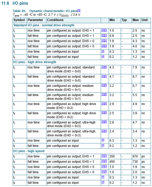

simon_prentice
  - How do you configure high-speed IO pins as detailed in the data sheet?
  - Does this apply only to certain pins?
