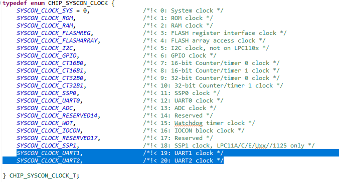

My   problem  about  LPC 1125 UART1 / UART2
. IDE : LPCXpresso V 8.22
.DEMO Board: OM13080
.I need 3 Uarts .
  With Example  “ periph_uart_rb”  Project  in   lpcopen_2_17_lpcxpresso_nxp_lpcxpresso_1125.zip,
TEST  UART0, It work  very well。 AS  I  initialize  UART1  & UART2  and test ,  They can not work well.
 I need your  HELP ,Thank  you  very much !!!
Owen

(3)Chip_UART_Init
 // The following FUNCTION only init UART0  ,In clock_112x.h  do not define SYSCON_CLOCK_UART1 ,SYSCON_CLOCK_UART2
  void Chip_UART_Init(LPC_UART_T *pUART) ;
Chip_Clock_EnablePeriphClock(SYSCON_CLOCK_UART0); //  uart0
         Chip_Clock_SetUARTClockDiv(1);    //  LPC_SYSCON->UART0CLKDIV  = div;
      /* Enable FIFOs by default, reset them */
      Chip_UART_SetupFIFOS(pUART, (UART_FCR_FIFO_EN | UART_FCR_RX_RS | UART_FCR_TX_RS));
      /* Default 8N1, with DLAB disabled */
      Chip_UART_ConfigData(pUART, (UART_LCR_WLEN8 | UART_LCR_SBS_1BIT | UART_LCR_PARITY_DIS));
      /* Disable fractional divider */
      pUART->FDR = 0x10;
If  i intialize UART1    、 UART2       The function “  void Chip_UART_Init(LPC_UART_T *pUART) ”  need modify:
  void Chip_UART1_Init(LPC_UART_T *pUART) ;
Chip_Clock_EnablePeriphClock(SYSCON_CLOCK_UART1); //  uart1
 LPC_SYSCON->UART1CLKDIV  = div;
void Chip_UART2_Init(LPC_UART_T *pUART) ;
  Chip_Clock_EnablePeriphClock(SYSCON_CLOCK_UART2); //  uart2
 LPC_SYSCON->UART2CLKDIV  = div;

 You need to add the  SYSCON_CLOCK_UART1 and SYSCON_CLOCK_UART2 defines in   clock_112x.h
and double check the UART interrupt handlers there is no uart2
I hope this helps,
