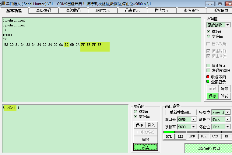

I'm in trouble with ISP of LPC812.
A command of ISP, "Read <address> <number of byte>" seems to be wired when I read an address, 0x3808, which is the middle of page 224. there is no problem when I read 0x3800, 0x3804 and 0x380C. ISP returns the correct data via UART. But only reading the address of 0x3808, the return data is 0x00000000. Whenever read data, I designate <number of byte> as 4. and keep word boundary.
Is there a bug?

Hi torukoyama,
   Please check my test result with lpc812max board.
1. Use the flash magic read out the 0x3800 address data:
All the data in 0X3800,0X3804,0X3808,0X380C is 0xffffffff.
Please check my ISP mode command:
0X52 0X20 0X31 0X34 0X33 0X34 0X34 0X0D 0X0A 0X30 0X0D 0X0A 0XFF 0XFF 0XFF 0XFF
It is:R 0 14344<cr><lf>0<cr><lf> 0xffffffff
14344: 0x3800
0:CMD_SUCCESS
0xffffffff: actuall data plain binary
You can find, 14344 is address 0x3808, the read out data is 0xffffffff, the same as the result from the flashmagic.
My chip is also LPC812M101JDH20.The revision identifier is 4C.
Wish it helps you!
Kerry
