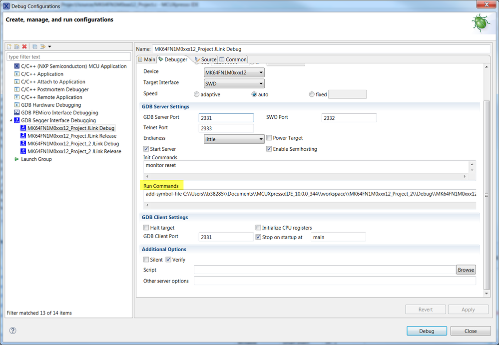

Yes, they are functionally identical. There could also be a problem with the SystemInit function, I would recommend you to debug both the bootloader and the application by adding the following command to your debug Run Commands:
add-symbol-file filename address
As an example:
add-symbol-file C:\\Users\\b38285\\Documents\\MCUXpressoIDE_10.0.0_344\\workspace\\MK64FN1M0xxx12_Project_2\\Debug\\MK64FN1M0xxx12_Project_2.axf 0x80000
The address 0x80000 corresponds to the first flash section of the second project which was previously flashed to the MCU:
Hope it helps!

juanabelaira
Mmm, I'm using LPC Link2, not Jagger, so I can't find the equivalent for my environment
