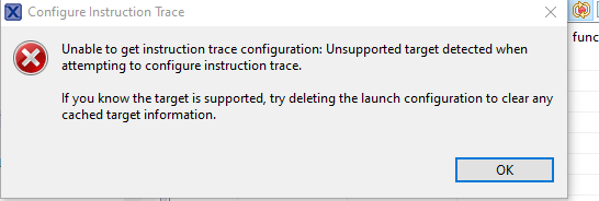

I am using a LPCXpresso54628 (OM13098) board and since I am getting some hard faults I would like to trace the code since the Fault does not report the exact problem where to look for the fault.
However, I am unable to set up the instruction trace for the board. When I click on the Record button the IDE says that the instruction trace is not supported for the target. Sreenshoot below.
I have deleted the launch configuration but I get back the same message. Am I doing something wrong? Using MCUXpresso IDE v11.1.1 [Build 3241].
Thanks for any help.
LPCXpresso54628
LPCXpresso54628

1. You don't need to set anything up in the code - the IDE will do this when you start trace
2. 'conflicting types' means that it is already defined - probably in a header file.

thanks for the info. I must say that the instructions found in MCUXpresso IDE Instruction Trace Guide misslead me since it says ETB is supported on a range of Cortex-M3, M4.... maybe that part of the text is not accurate enough, especially for somebody not familiar with tracing, or maybe it is just me :smileyhappy:
Nevertheless, I will look into it although I just found some info How To Use SWO Trace on MCUXpresso IDE for the LPCXpresso54114. I presume it can be scaled to fit the LPCXpresso54628 (edit: SWO pin is PIO0_10).

converse
Senior Contributor V
That’s correct. MCUXpresso supports devices with ETB or MTB for instruction trace. The LPC54 devices use ETM for instruction tracing and thus are not supported.
The essential difference is that with ETB/MTB the traces instructions are captured in RAM on the device and then read out by the debug probe and decoded with the debugged. With ETM the trace is streamed directly through the trace port - at very high data rates. You need special hardware to capture the trace data.
