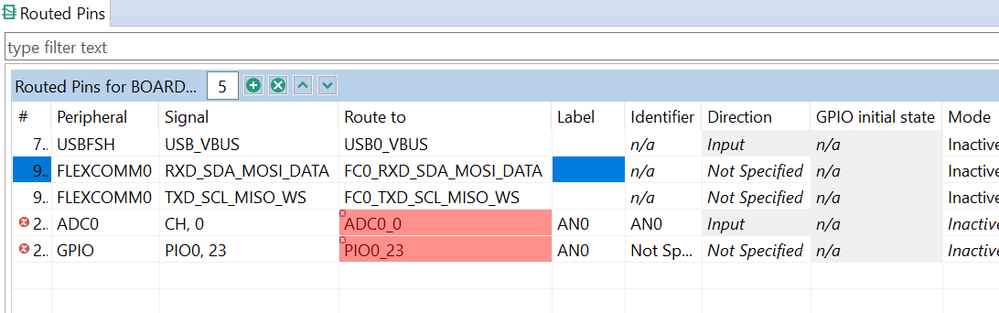

As an example, I am adding to the USB_VCOM_FREERTOS example an ADC on PIO0_23.
The analog switch input control is set by the tool.

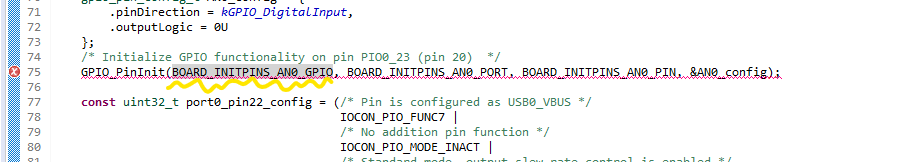

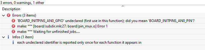

And on the build these errors are thrown.

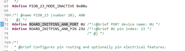

Looking at the code shows me there is a define missing.
And as visible in the pin_mux.h file it is really missing.
I think there should be an extra line like this (please correct me if this is wrong):
#define BOARD_INITPINS_AN0_GPIO GPIO

I reproduced your issue on my side. I will escalate to config tool team. I will keep you informed.

This defect will be fixed in next SDK release. Thank you for bringing the problem to our attention.

dingelen
Hi Jennie,
what you are saying is not the issue that I have. Please read the description carefully.
I get a compile error due to a missing define in the automaticly generated pin_mux.h file.
UPDATE: THIS ONLY HAPPENS WHEN A LABEL AND IDNETIFIER ARE ENTERED
Without label/identifier:
With label/identifier:
