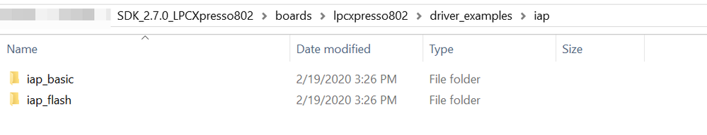

ZhangJennie
Asier,
iap demo code isn't included in the older SDK package. But I just checked it was included in the latest SDK2.7. please download the latest SDK 2.7.0 then find it here:
\SDK_2.7.0_LPCXpresso802\boards\lpcxpresso802\driver_examples\iap

ZhangJennie
Asier,
Jun Zhang
