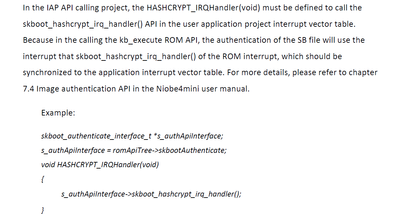

Hello andrewfisher,
Please have a look at 3 IAP API Demos of ROM_API.pdf, it in UM attachment,
especially the below part:
Alice

andrewfisher
I really cant see how the attached ROM_API.pdf document explains anything. Quite apart from the fact it keeps referring to the Niobe4mini user manual - which can be found nowhere! ROM_API.pdf is all about the boot-loader API which is quite separate from the Image Authentication API.
I currently have my signed image flashed into ROM using my own methods. I can check it visually from the debugger and it all looks good. I now want to call the API to verify the image is authentic before passing over control. Currently I am calling skboot_authenticate() on the image and it returns a fail. But I can also see that the HASCRYPT_IRQHandler never fires.
I have tried initializing HASHCRYPT manually before the call and nothing changes.
What would be actually helpful is a working example of how to use the skboot_authenticate() function call.

Hello andrewfisher,
1)  "Niobe4mini user manual" is UM11126, sorry for the typo in the PDF.
2) Usually this API is used by ROM during secure boot.  There is no example about use this in user application so far, only can check the 7.4.1 of UM.
And as UM, it also used to verity authenticity of the SB 2.0/2.1 files, not all files. What about your file?
