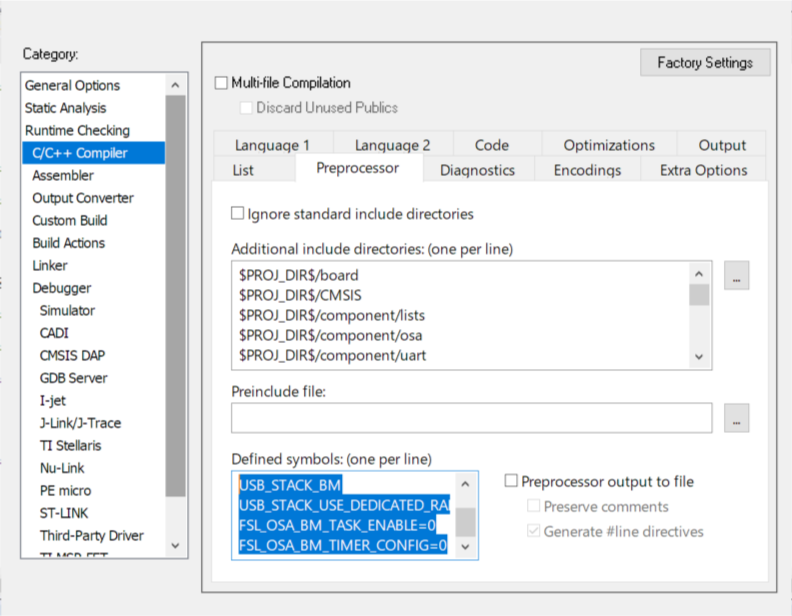

I want to use dev_msc_ramdisk_bm of LPCXpresso55S16SDK with USB1 (USB high speed mode) of custom LPC5514Board.
It seems that kUSB_DeviceEventBusReset is recognized, but kUSB_DeviceEventGetDeviceDescriptor is not recognized.
The changes from the SDK are only the following items except for the file for LPC5514. Is there anything else I should change?
Also, is it correct to think that an interrupt will occur when recognizing kUSB_DeviceEventGetDeviceDescriptor?

Some IDE symbols were missing.
Thank you for your cooperation.

It was caused by not declaring the definitions required to use the SDK. In the case of EWARM, it is the part of the image.
