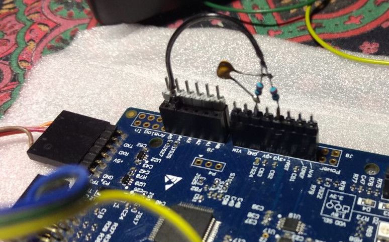

using the NXP OM13089 LPC54114 eval board i ran into a, to me unsolvable, ADC related problem
i connected two 270 ohm resistors in series between J8.12 3.3 V and J8.16 GND and a 0.1 uf bypass cap across the resistor connected to GND.
the center tap between the 2 resistors (1.65 V) i connected with a wire to J9.10 ADC0 channel 7. the example apps use ADC channel 7
therefor the supply voltage to this resistor divider is 3.30 V and the center tap at 1.65 V (note the bottom resistor to gnd has a 0.1 uf bypass cap connected across it)
full scale input of 3.3 V should result in a reading of 4096, which it does, as well as 0.0 V input yields a correct reading of 0 V.
however a 1/2 scale input of 1.65 V should result in values near 2048 but in reality it produces 2178 which is a 3.17 % error on a calibrated 12 bit ADC ... this seem TOTALLY UNEXPECTED.
i tried the same 2 example apps (basic and interrupt driven) on a 2nd untouched brand new OM13089 eval board with the same results.

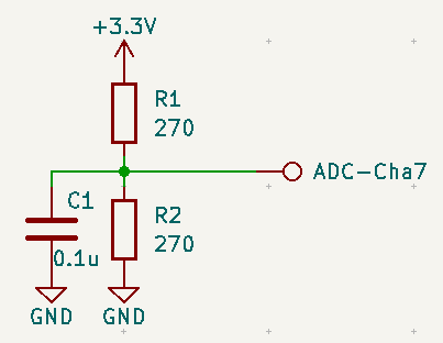

to make my ADC channel 7 test hookup visually easier to understand i provide a small schematic clip
given that the two 270 ohm resistors are on Vcc and Gnd on a low impedance source connected, we can see the impedance to the ADC cha 7 as 2 parallel resistors. now we have 135 ohm feeding ADC cha 7.
according to UM10914 rev 2.0, 9 may 2018, NXP user manual the minimum required sample time with up to 200 ohms is 50 ns with a TSAMP of 2.
the cycle time at 80 MHz ADC clock resulting in 12.5 ns x 4.5 is 56.25 ns which should be sufficient by the suggested values in table 522 page 506.

the hookup oft the two 270 ohm resistors to +3.3 V and GND as well as the wire to ADC cha 7 can be seen in the provided pict
the input voltage into the ADC cha 7 was 1.629 V (about 0.6% below 1.65V), Vcc is at 3.280 V (about 0.6 % below 3.3 V).

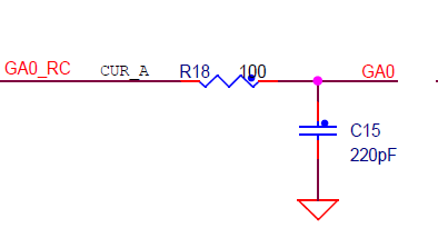

I suppose that your resistor divider circuit has issue.
First of all, pls try to remove the capacitor or change the cap from0.1uF to 200pF, the 0.1uF is too large, which leads to large time constant to charge the cap.
Secondly, you use two 270 ohm resistor divider, can you use smaller resistor divider? I suppose that the ADC analog channel has low impedance. If you can not use smaller resistor divider, I suggest you use a analog buffer based on OP amp.
This is the analog RC circuit for ADC channel for the other processor.
The GA0 is analog ADC channel pad, the GA0_RC is the tested voltage source.
Hope it can help you
XiangJun Rong
