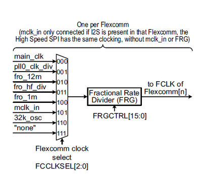

I'm setting up a FlexComm module for I2S operation on an LPC55SS69 and I'm finding the documentation to be very scattered and kind of inconsistent. I think I've got it, but I could use some input here to make sure I've got this right.

So what I've got now is a 150 MHz output from PLL0 being divided by 4 to get 37.5 MHz at pll0_clk_div, FCCLKSEL0 set to select that clock as input to the FRG, the FRG set to 400/256 to yield 24 MHz for FXCOMCLK0 while keeping it under the 25 MHz limit, and DIV is set to 10 to divide it to 2.4 MHz.
Is this correct? And is the pll0_clk_div signal used for anything other than FlexComm modules?

Hi, Scott,
Pls refer to the following pic in section 4.4.1 Clock generation in UM11126.pdf
The FCLKx is the only driving clock of FlexComm module, the FRGx can be a divider ranging from 1 to 2(for example the divider can be 1, 1.1, 1.2...). For detailed inf, pls refer to section 4.5.49 Fractional rate divider for each Flexcomm Interface frequency.
So this is the I2S clock divider link you are using
PLL0_clk--------->PLL0_CLK_DIV------------>FCLKx------------>I2S bit clock
1)From PLL0 clock to PLL0_CLK_DIV clock, you can set PLL0 clock divider reg, which ranges from 1 to 256. For detailed inf, pls refer to section 4.5.59 PLL0 clock divider in UM11126.pdf
This register determines the divider value for the PLL0 output, if used by the application
2)From PLL0_CLK_DIV to FCLKx, here x represents the FlexComm module index, pls refer to 4.5.49 Fractional rate divider for each Flexcomm Interface frequency, you can write the FLEXFRG0CTRL to set the fractional clock divider from 1 to 2.
3)From FCLKx to I2S bit clock, pls refer to 37.7.4 Clock divider register, you can write the Clock divider register (DIV, offset = 0xC1C) to set up the divider, the divider range is from 1 to 4096
with above setting, I suppose you can get the required I2S bit clock
Hope it can help you
XiangJun Rong

Can you confirm that pll0_clk_div is only used by FlexComm modules? I've got the baud rate I need, I just want to make sure I'm not going to be causing problems for myself elsewhere by changing the divider there.
Scott
2,138 Views
xiangjun_rong
From the UM11126.pdf, I suppose that the pll0_clk_div clock is only used by FlexComm modules, it is not used by the other modules.
