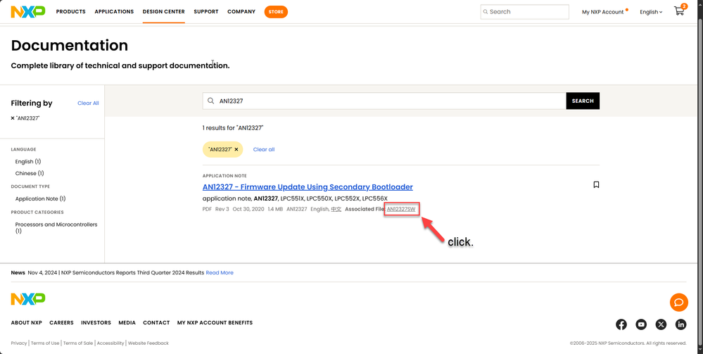

Also, in the same app note (AN12327) are mentioned two codes where you can find both in NXP documentation clicking the next button:
I highly recommend take by reference the SDK (version 24.12) example called "mcuboot_opensource", where is in the LPCxpresso55s69 SDK.
