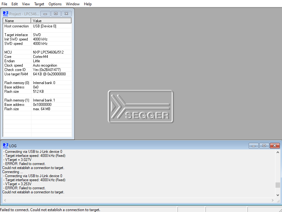

I'm using LPC54606J512 with SWD interface but I'm not able to connect MCU using J-Flash. I'm getting error message as -
ERROR: Failed to connect.
Could not establish a connection to target.

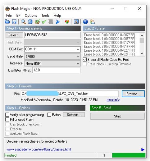

I'm able to erase MCU and then download code using Flash magic through ISP mode. The MCU runs correctly, but not able to connect using J-Link.

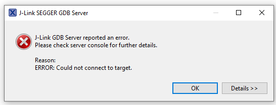

Is it the first time you download application code after design?
-> I have tested this board multiple times before this problem arrived.
are you sure that the power supply pins are connected correctly? I suspect that the LPC54606 can not start-up because of hardware connection.
-> I have downloaded code using Flash magic and it is working fine.
-> I am able to send and receive data on UART terminal.
-> I am able to send and receive data on CAN channels.
That means my hardware setup is ok and it's working. I just can't debug my hardware with JTAG.

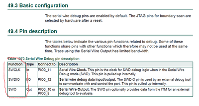

The LPC546xx supports only SDW instead of JTAG, pls confirm if you use SWD or JTAG port on your target board.

Sorry I wanted to say J-Link.
I'm using SWD port only.

I have checked with J-link commander but getting same result.
J-Link>connect
Device "LPC54606J512" selected.
Connecting to target via SWD
Cannot connect to target.
Can you tell me how to reset the device with J-link commander?

J-Link>reset
->Connecting to target via SWD
->Cannot connect to target.
Still getting same error. What to do next?

As a test, pls try to use MCUXPresso tools to build and debug the project, and check if the tools can identify the J-Link device and download code.
